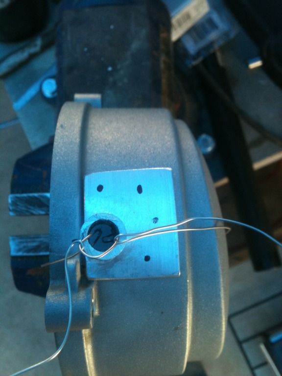

No room for boltsSounds like bolt through fitting would be the best solution then.

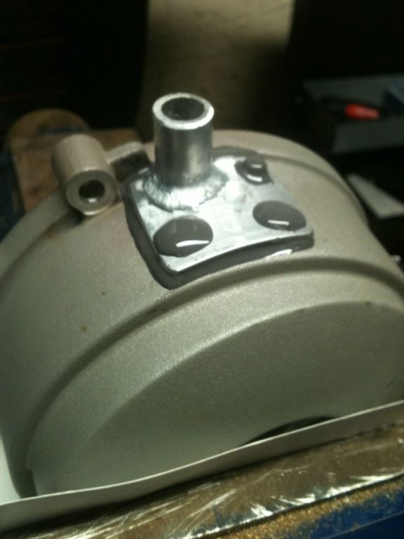

maybe a CNC or welded fitting that rivets to the cover with JB weld as the sealer

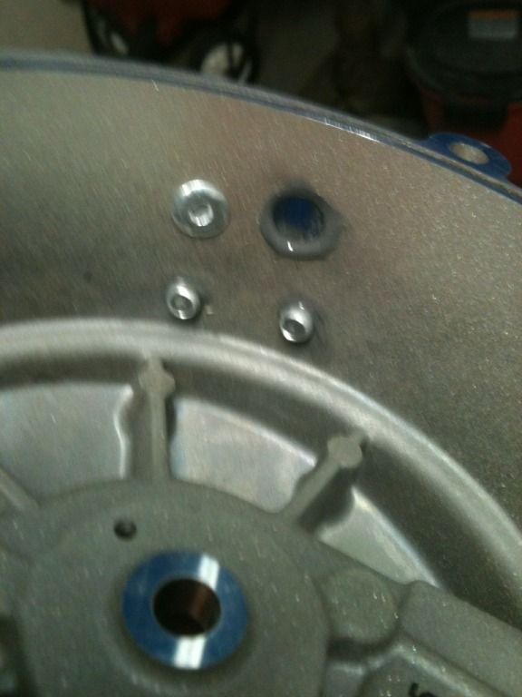

Not actual bolt's. Threaded fittings that go through the hole.No room for boltsmaybe a CNC or welded fitting that rivets to the cover with JB weld as the sealer
The cover is only about 3mm thick . Behind the cover about 2mm of room .Not actual bolt's. Threaded fittings that go through the hole.

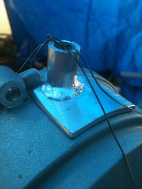

I sure hope this works . Might be good for a utility patonYes, I built a oil cooler and it was successful enough to have Husqvarna contact me. But, this is Randy's project/experiment. I suggested brazing because it fell within his means for the prototype and should work perfectly for this application.

It's not going to warp with a propane torch.
Hmmm... Wouldn't stick? Mine stuck like a fat kid holding a cup cake.

Then the cheep aluminum JB weld rivet fitting is perfect !The casings are made of an unusual alloy blend which yields a lot of impurities.
