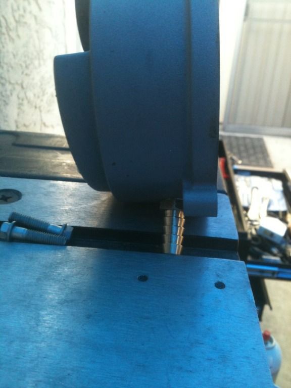

Well I can't sleep thinking about poking a hole in the coverI have allready thought of 3 different ways I want to make the oil pickup. My newest idea involves a $3.50 brass hose barb and some Blue Magic Quick Steel putty that's rated for 500 degrees .. No welding !

I would to but I have never done brass to aluminum and that might mess the coating on the cover ?I would braze it.

I don't think it would harm the anodizing, but it would open up the possibility of aluminum AN fittings to your magnesium cover.I would to but I have never done brass to aluminum and that might mess the coating on the cover ?

Sorry, it didn't register.Will 60/40 lead acid core work on magnesium ? How would you go about brazing it ?I would braze it.
FYIWill 60/40 lead acid core work on magnesium ? How would you go about brazing it ?
