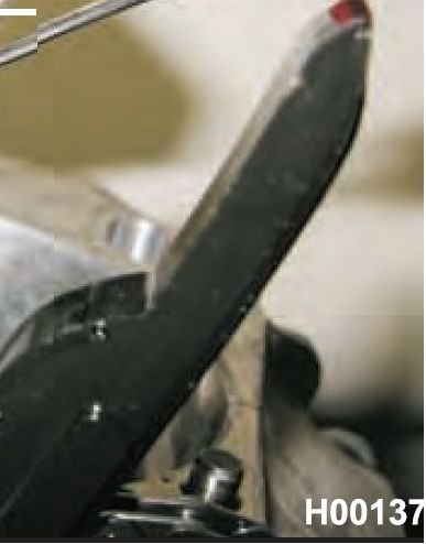

It looks as though somebody has lapped the tapered part of the crank and the internal taper of the flywheel together to get a perfect match on the angle. It's usually done with valves and a lapping compound (abrasive paste) to make sure two surfaces mate properly. It usually leaves a dull area where the microgrinding occurs. The taper on the crank has that appearance.
Ah, that is why it was so tight. They might have used retaining compund too.
Looks a little like a part of one of the cam chain tensioner halves. I'd look thoes over closely.
Were the ends connected to each other to make a cylinder at any time?
Also somebody on here mentioned about the old and new taper on flywheel or stator. I know they where updated but do not know when and what part numbers where changed...
Could that plastic be a piece of the timing chain slider? Looking at the workshop manual it seems to be two pieces bonded together.
May just be an illusion but I can't think of anything else in there that is "Plastc-like". I haven't had to open mine up so I'm just going by the pic.
I don't think the part numbers were changed....just the machining a little. The flywheels have the week and year of manufacture stamped on them.
Do you see how the flywheel in the pic does not contact the crank end about 6mm or so? That looks like the flywheel taper I took of my bike. It was made mid 2009
The later dated flywheels (Nov 2009) have a taper that contacts the crank all the way to the end.
