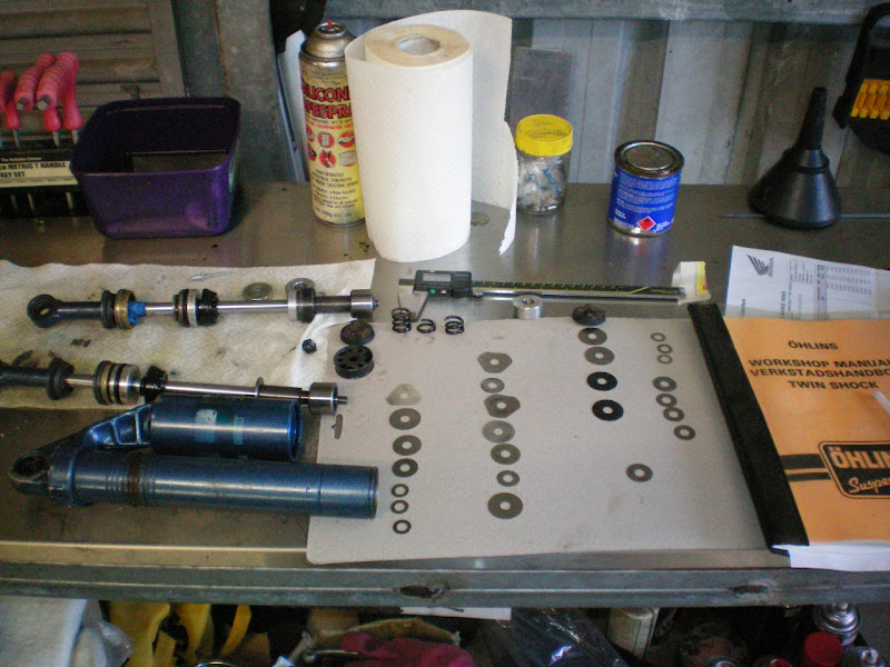

pulled aparts shocks

Bit rusty in the brain, as I did this a few years ago, but if I remember correctly the triangular shims are stock, and no longer made. I think theyre only on the rebound shim stack? a smaller shim will do the same thing or if you must have one, grind it!
I sourced my shims from an ohlins dealer here in Australia, but I imagine anyone working with them in the usa would supply you?
There are some good Ohlins sources in the U.S. I'll post what I find out. And, yes, we have the option of starting with a round shim and trimming to the delta shape. Thanks!
Still scratching for the manual.
I ground a small screw driver into a scoop type shape to make it get it in there easier.
You may know this but ill throw in anyway
I think you can push the seal head down a little if the piggy back reservoir is open to atmosphere to make easier to get at the circlip.- put a socket on the seal head (over the shaft)and give it a good whack .I normally tap the circlip down with a screwdriver and small hammer just enough to dislodge it, as its very hard to get in under it , and to get the seal head out I pressurize the piggyback reservoir using a mountain bike shock pump and it should pop out enough to pry it out.
