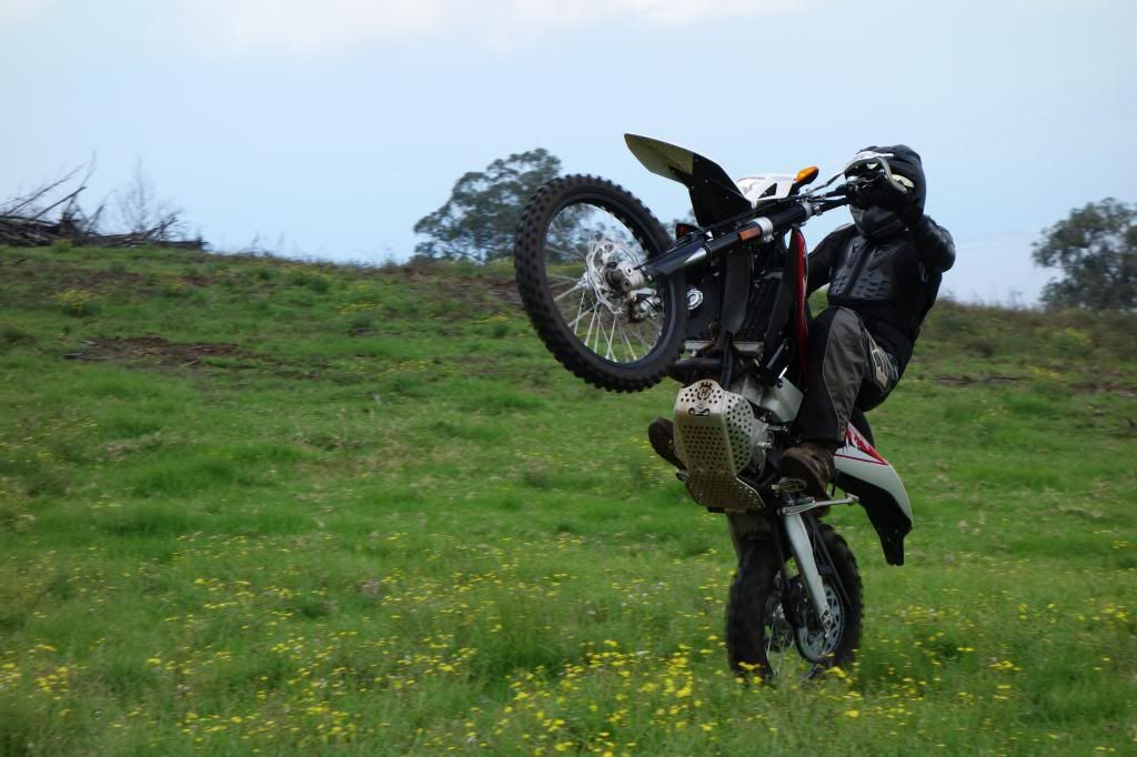

Showing off the fancy shmansy Up-tite skid
