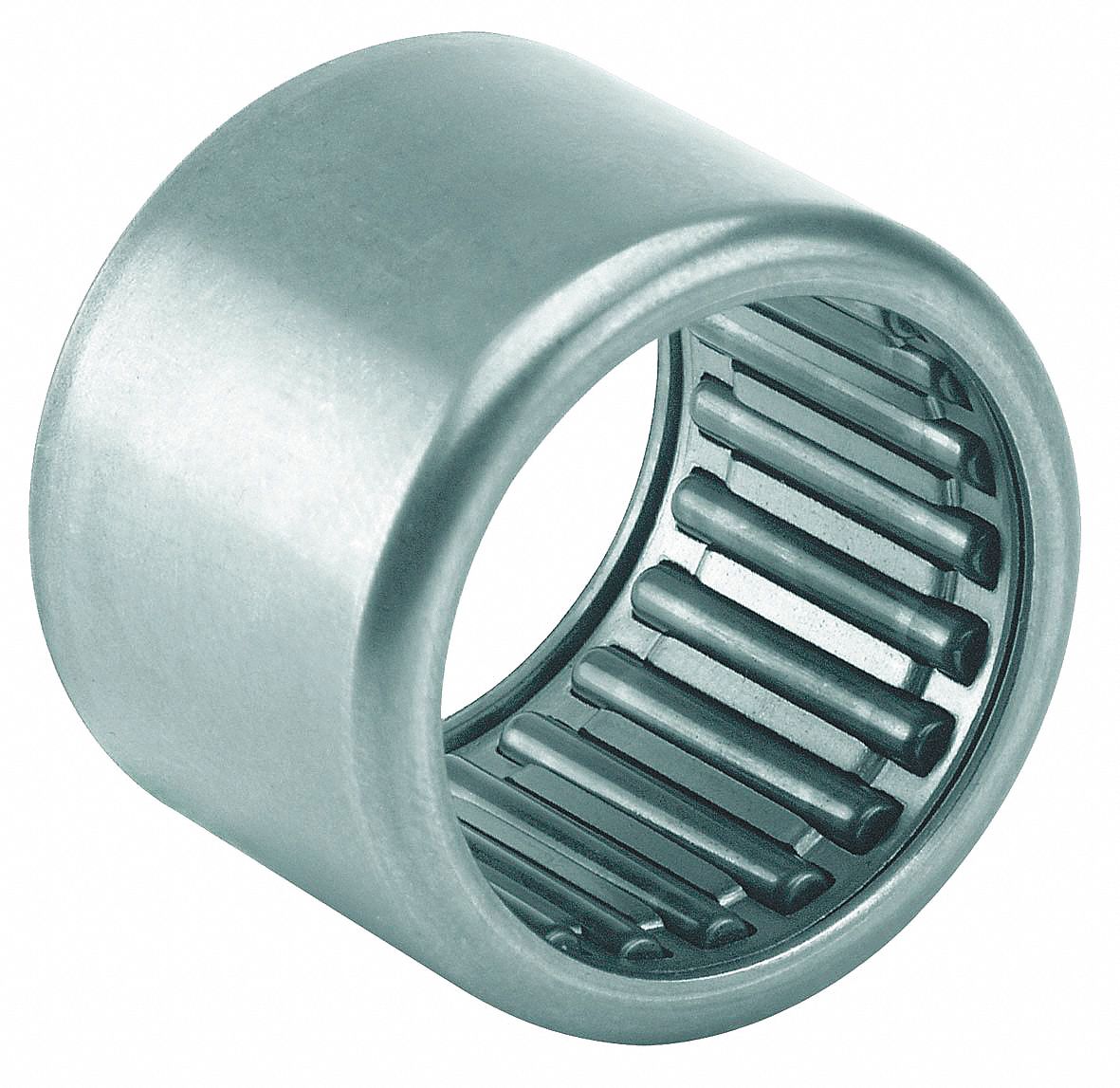

I would post a picture but yours pretty much describes what mine looked like! I found all of the bearings locally except for the only one that is a different size (and most likely to go bad first) which is the one for the shock. The wider bearing fits but the seals won't go in flush so I wrapped the entire end of the shock and link tightly with an old tube until i receive the proper bearing.

I had to use a longer bearing in the lower shock mount (same size as in the rest of the suspension) because they were out of stock. The seals won't fit with the longer bearing in so I've wrapped the area with an old MTB tube until the new bearing is in stock. Just checked it after a long muddy ride and the bearing's "clean as a whistle". I'll probably keep it wrapped even after changing to the shorter bearing and seals.ray_ray-"The SA has space for longer roller bearings .. Has anyone tried putting an extended length bearing there?"

That's a good tip- to zipty a little flap cut from a piece of inner tube onto the front of the linkage to protect the lower shock bearing. This limits direct blast/splash from the front wheelI had to use a longer bearing in the lower shock mount (same size as in the rest of the suspension) because they were out of stock. The seals won't fit with the longer bearing in so I've wrapped the area with an old MTB tube until the new bearing is in stock. Just checked it after a long muddy ride and the bearing's "clean as a whistle". I'll probably keep it wrapped even after changing to the shorter bearing and seals.
Get the HK2016-AS1 in the photo above.
