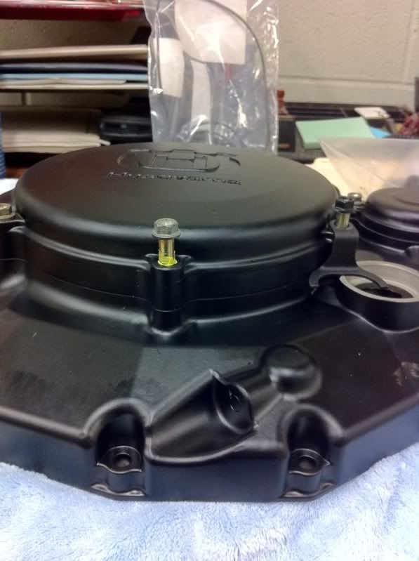

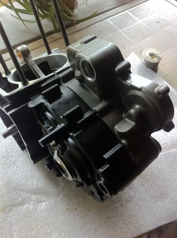

Ok here you go. 06 and 04 cases match up. The black case is the 06 that I powdercoated. What I do know is if you use a 04 right side outer case you must use a 04 right center case. And vise versa. On the right side Like in the photo another cover bolts up. Then your cluch cover goes on. Follow??
Ok found a pic. This bolts to the right side center case. If your right side center case is a 04 you need a 04 case like this.
If you right side center case is a 05-10 then you need the cover in tge pic to match those years.
OK I get it now, thanks! Didn't realize the case was actually three pieces, thanks for checking for me. Great job on the powder coating by the way!
very very nice powder coating! congrats
