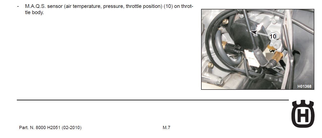

Some owners have had problems with water in the harness plug (socket) at the throttle body. Some also had water get in the throttle body plug itself and create no-start problems. The barometric pressure sensor (which supplies intake pressure voltage) is built into the throttle body.
All throttle body has also been dismantled and cleaned up by the mechanic as it was suspected for water trap inside. Does it mean a ‘TP’ sensor for the barometric sensor ?

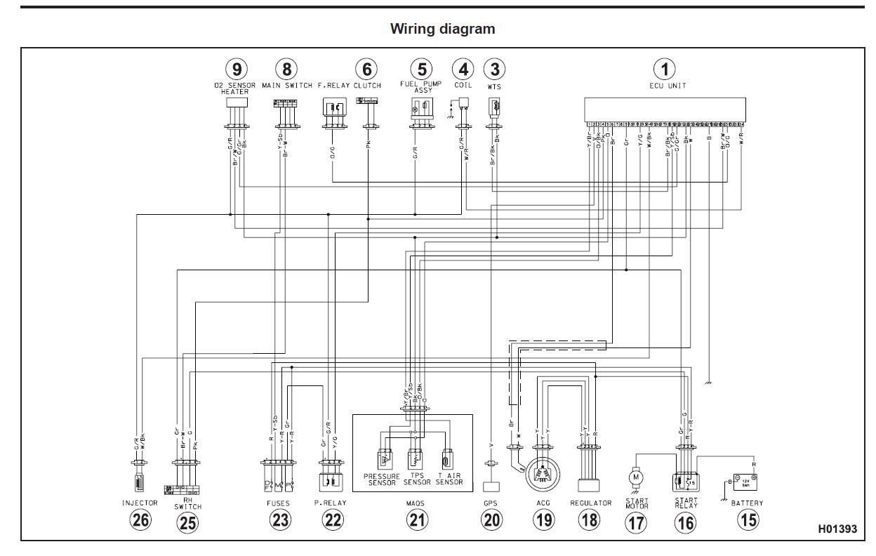

Your pressure sensor is not reporting a value so you have either a defective sensor or connection problem. Because it's internal to the throttle body your only option may be to purchase a new throttle body. I remember that some have replaced the TPS on the TB but don't recall anyone going after the pressure sensor. If it was me, I'd be looking around inside the TB for the sensor hoping it's a replaceable item and making sure it wasn't a corroded connection issue (a new TB is expensive).
TPS itself looks a replaceable items. The Husq mechanic who handled my sms 630 has dismantled the TB and cleaned the TP sensor connections (But it did not heal the bike). Indeed from my search the TP is one package part with the TB and it’s expensive ….:banghead:
