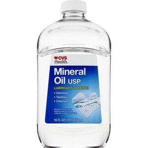

Mine has leaked on rare occasions since it was new. Flushed it once very early on, nothing since in over 6K miles. I used plain mineral oil in it from the drug store.
Also called a laxative, so my MC can poop easily. :applause:
Yea, I think that's more or less what I have, not the scented kind. From what I can figure from reading online, the biggest difference between the plain laxative mineral oil, and brake/clutch specific fluids, (besides the price) is the viscosity. Does it affect lever effort or clutch action? Not that I can tell.

I highly doubt there is much variance in viscosity between commercially prepared clutch fluid and light or medium food-grade mineral oil. There is plenty of information to browse and study online if one wishes, I'm not going to bother.
Regular mineral oil works just fine in them. If you're uncomfortable at all about it just buy the magura-blood fluid from your favorite motorcycle parts dealer.
