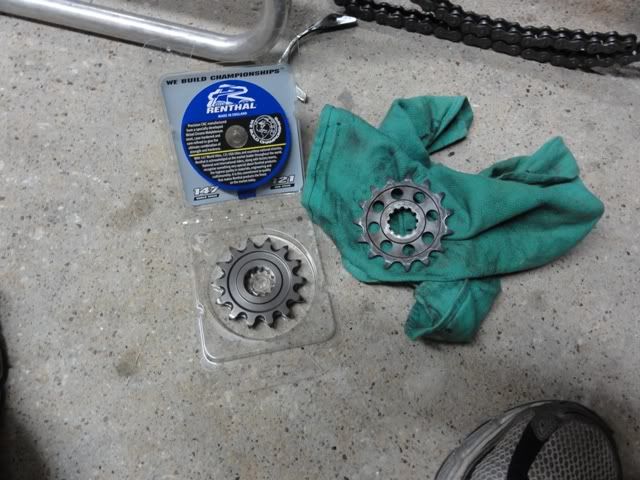

I know alot of you have already dropped to a 14 tooth front sprocket, for those that have'nt, give it try. Now my 630 feels-accelerates almost like my 450 (ya-know...except for the extra 80 pounds)

I agree with the simple instilation of a $20.00 Moose Racing or Renthal 14t sprocket, the overall gearing is much better. First gear is lower and you won't be grabbing for the clutch as often while driving slow. Top speed is still up to 100+ mph depending on engine mods. The stock chain can be used with out removing links.
