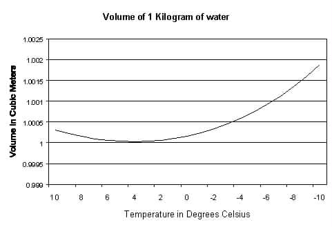

Well, technically....
And as far as the weld goes, it's more about breaking the bond between the race and the neck tube. The race expands and then contracts asymmetrically due to the weld, so it's then easier to drive out.
Yes I think we are agreeing.
