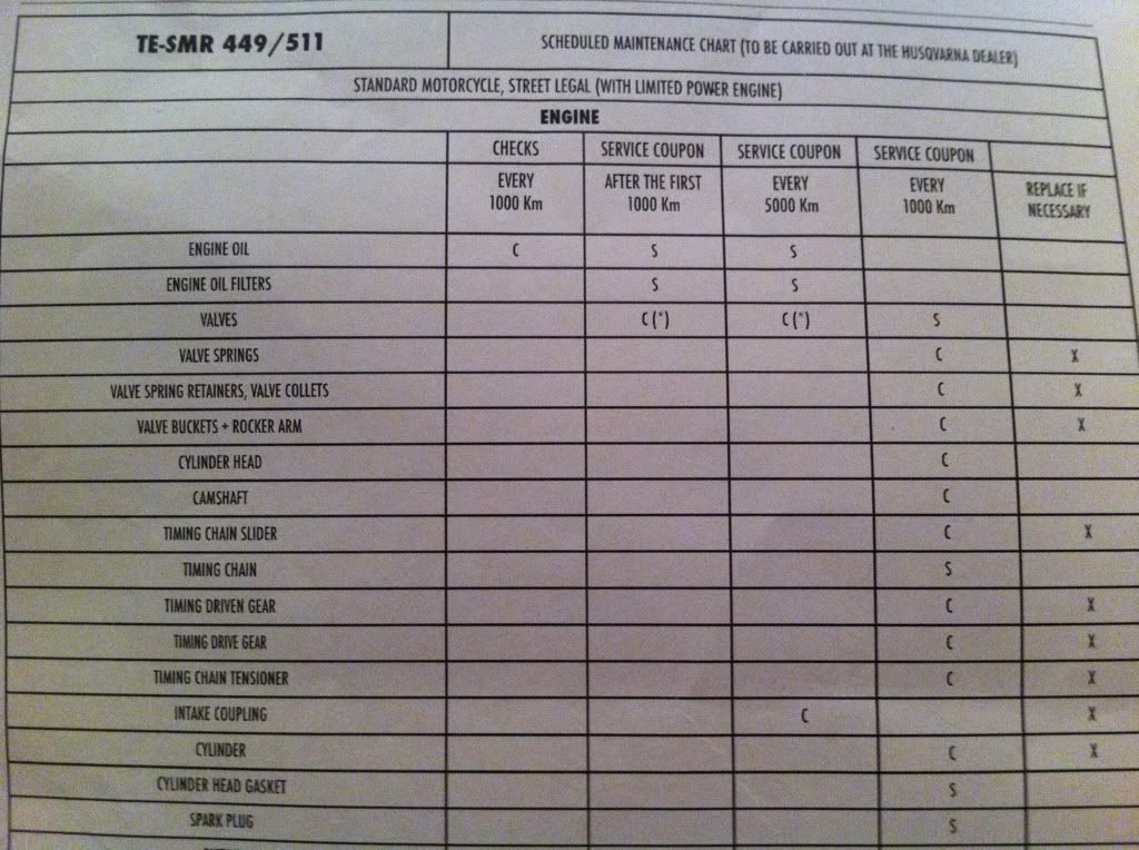

The 70h bit appears to be from the MX/Racing schedule in the TE/TXC/TC manual. In normal use the TE/SMR's have a First 1000km, every 1000km, every 5000km and every 10000km schedule. My mate has lost his USB which has the more detailed schedule listed, but I'll kick him in the shins til he finds it.
Right, no doubt they assume if you are in race mode then you may be racing and ought to do race level maintenance.

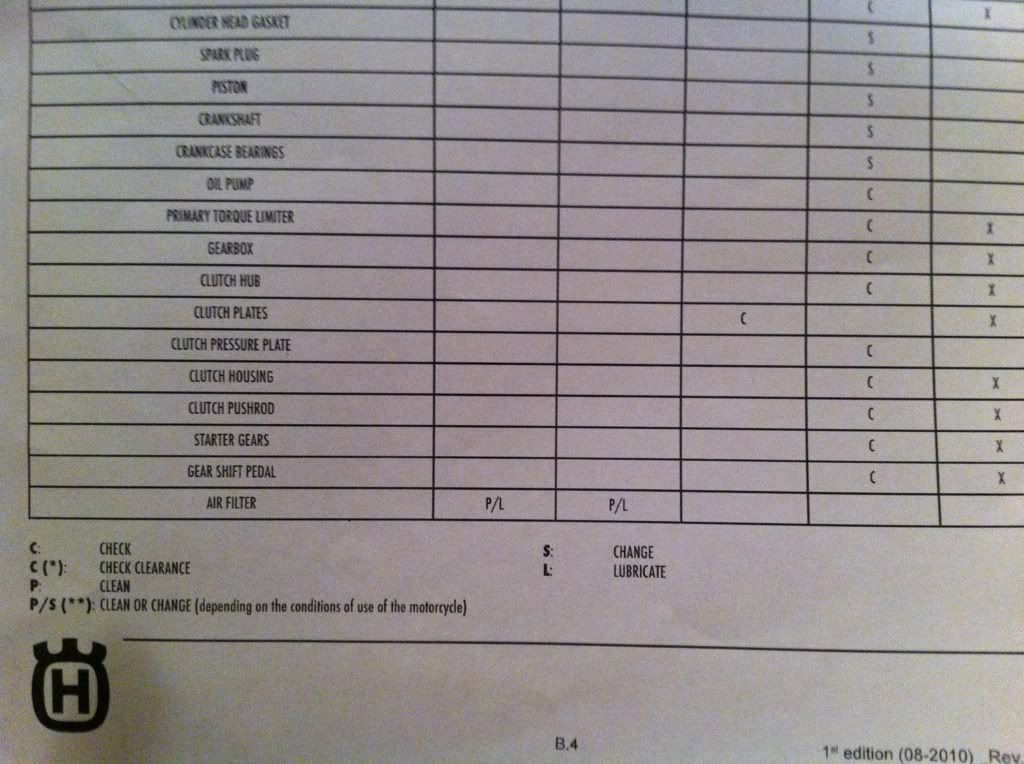

I found this in my box of bits i got me husky.
Husqvarna Why has not done a full power on the street, because there is only a limited power on the street, then there is only a full power on the track use:excuseme:
By removing the limited power setting in some markets the bike is no longer street legal, also the warranty is goooorn from 1 year to 3 months, or possibly even no warranty. BVasically you can have one or the other, not a mix of both. If Husky made a full power road maintenance shedule it'd cause them alot of pain re. warranties etc.
