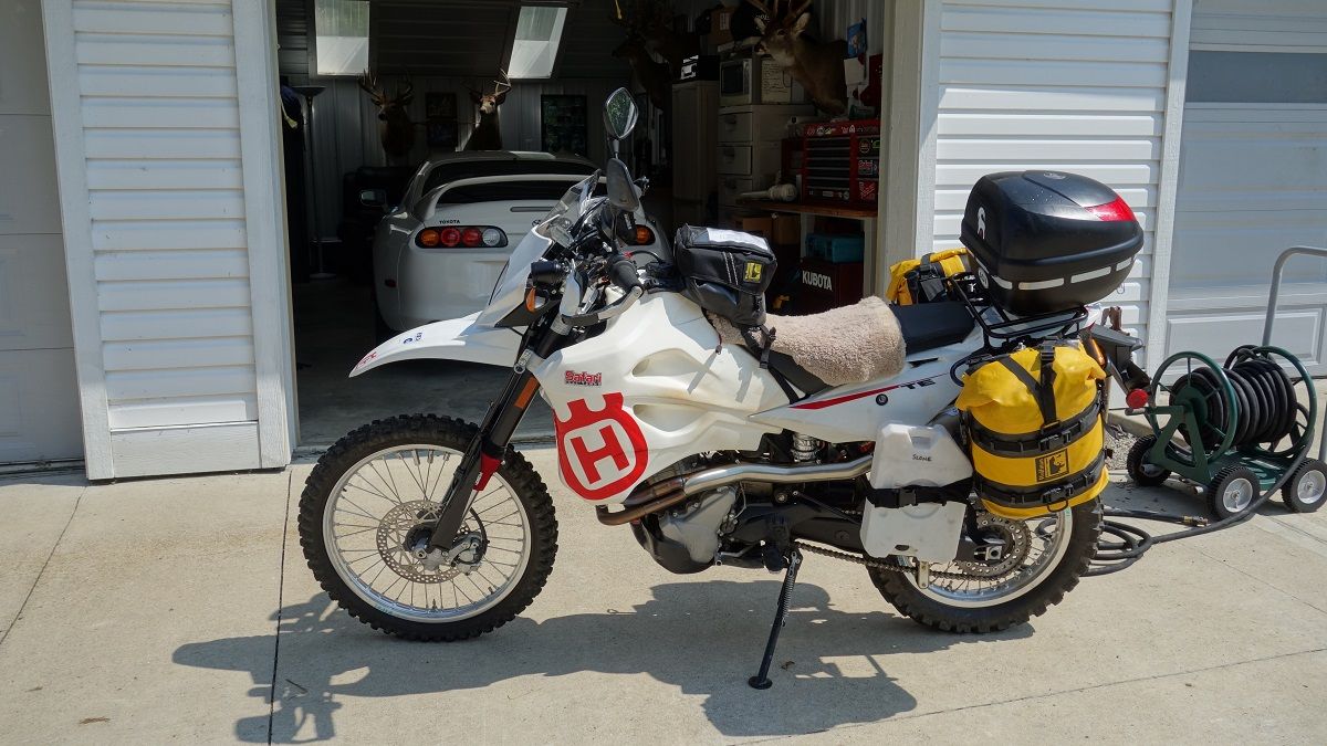

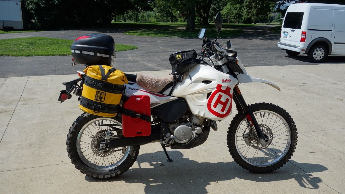

Went to Catskills this weekend, it was work related but I made it all about having fun, brought the bike and rode close to 200 miles. Finally finished the first 4 gallons I put in few weeks back and then another 2/3's of the tank.
So far so good, one minor issue is that when gas is low (last 1/2 gallon) bike stalls at idle, but It's getting 46 mpg and with 3 gallon rotopax I should be good for 350 miles, so not really worried about using up last drop.
Still have the hick-ups at steady cruise around 50-55, so I messed with the mixture, idle and checked for vacuum leaks, and then while doing the valves and hoses tonight I pulled the needle, pretty sure it's the culprit: looks chewed up at that 5% throttle spot.. too late to have it shipped in, ferry leaves Thursday Afternoon. I'm not even packed...
