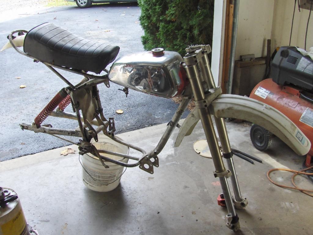

I have a frame with a rear wheel missing, engine pulled out. I don't think there is an exciting picture to take of it right now. :)
You are wrong on that, we like pictures of everything**************************************** More the better. We like to see what you started with how it progressed and final results, so post up!!!

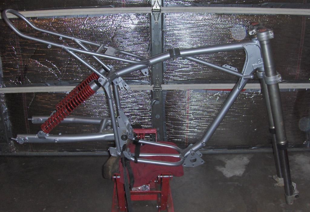

It's been awhile since I've posted here. I intended to start this project last year, but got busy with life. So, here I am at the same place I was when I left off. Right now I'm looking into doing a 390 conversion. It looks like I need to pick up a frame as well.
I'm finally getting serious about it. There is a 1990 KTM 125 MX sitting around with WP inverted suspension on the front. A crazy idea popped into my head. Now they have replaced the standard forks.
NYCMX...nice bike!
Oh, I know someone might ask why. Why not? Make that old puppy handle a little better. Maybe? The surfaces on the stock forks are toast. A lot of rust and pitting. I have to replace them anyway. So, another problem solved. Actually, I will probably pick up a set of the standard forks at some point just to keep around.
I've been giving myself one hell of an education on the Husky's from this era! All part of the process when diving into something new. New swingarm bearings installed. Cleaned up the Curnutt's. I know the Curnutt's came with a gray body, but I went with black. This is going to be a rider, not a "correct" show bike, so...not much concern with the little details. Waiting on new fork seals for the WP forks to come in. Slow, but...steady progress.
