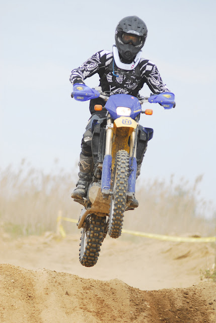

Been there done that:
Finished right in the middle of C-open, not bad for the big girl.
If the course gets tight, it gets bad, but this was at Sahara Sands which has a lot of fast stuff, and the big girl did well...
Still the WR is definitely faster almost everywhere!
