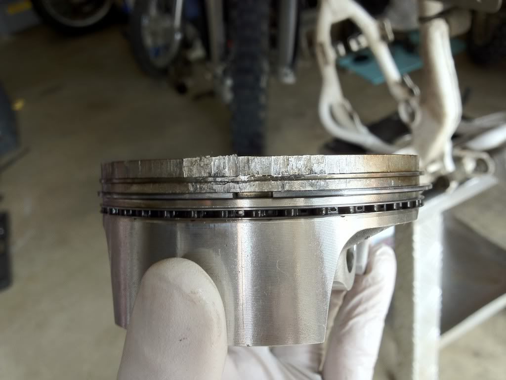

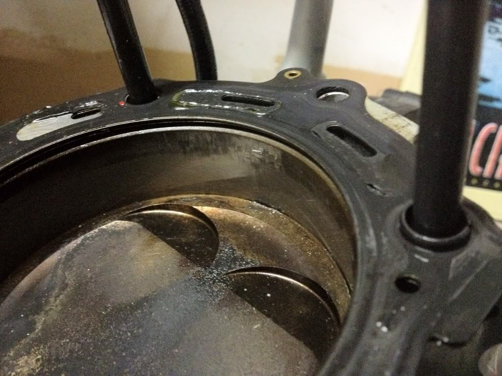

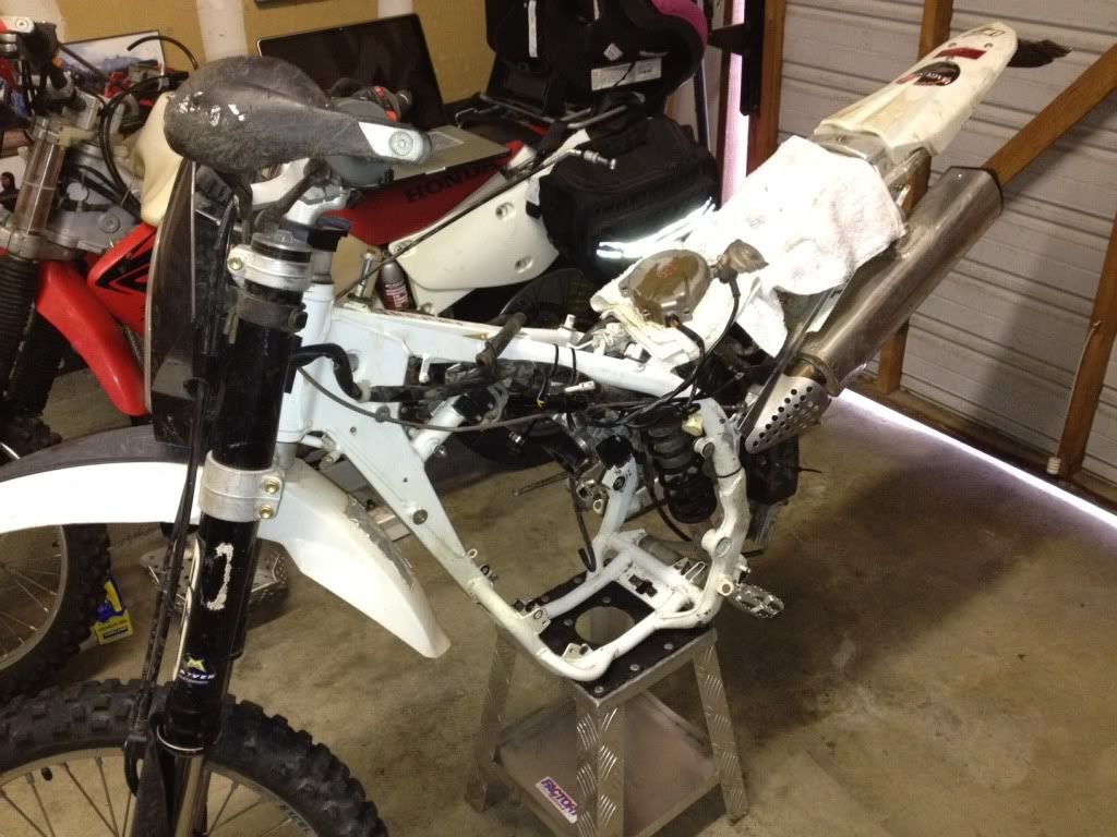

OK guys, had a bit of a "T" fitting mishap which led to premature clutch failure, left me fresh out of coolant and sputtering, smoking my way back to the truck with my tail tucked between my legs... Being the preventative-maintenance kind of guy that I am, I decided that I should really have a looky-loo and get the low-down on the real-poo. Aside from scorching my oil (and without having split the case), it doesn't appear that any real damage was done except for the piston and some scoring on the cylinder:
Have a few questions for the collective CH brain trust. I've been doing a bit of poking around reading various threads about compression ratio and thicker head gaskets vs. shaving the piston, upgrading the water pump, etc... (By the way, that Foolproof Cam Timing thread is brilliant!). Curious, since I've got my bitch torn-down, what if any reasonable upgrades I should make before slapping her back together.

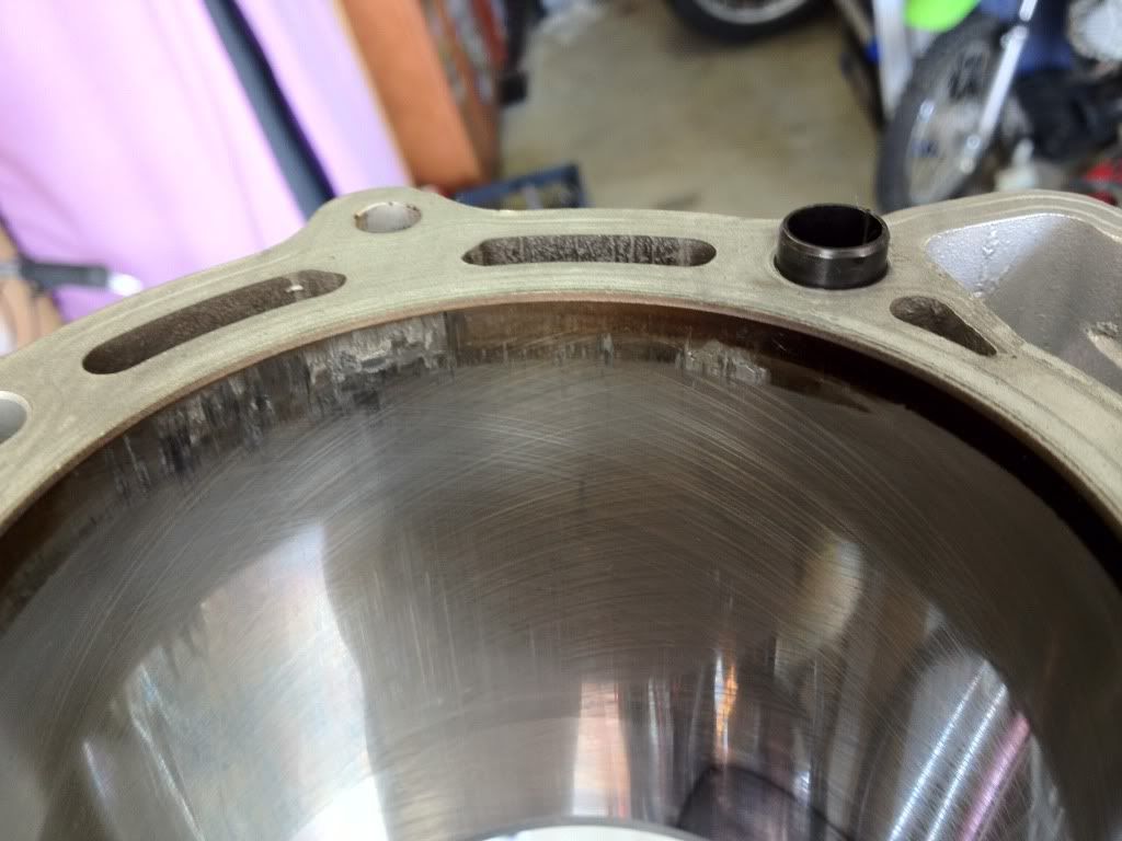

I know I need a new piston, head gasket, etc... Not sure whether I can salvage the cylinder (really doesn't look / feel that bad - hand hone??)

I melted a piston in a yZ426 once. Took it to a local motor builder and he diamond honed the melted aluminum off the cylinder in about 25 seconds.
New piston, rings and back off to the races.

T fitting, ouch. That has been left in there 4 years to many. ('08?) You can get an affordable UpTite Y or the 2010 one piece rad hose for the rebuild. Im not an expert, but I would try and clean up and resuse that cylinder.

When the fuel tank is off, sheilding the clutch line with some fuel/vacume line wouldn't hurt.

Not worried about the jug, should be easy to clean up...
