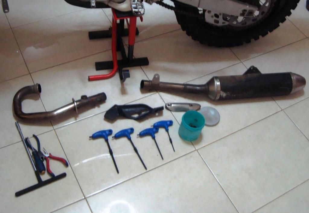

It's off the bike. As you can see I've already painted the canister but had a bit of a crash in the woods and scratched her up again so I decided to spruce it up before my next ride(crash).

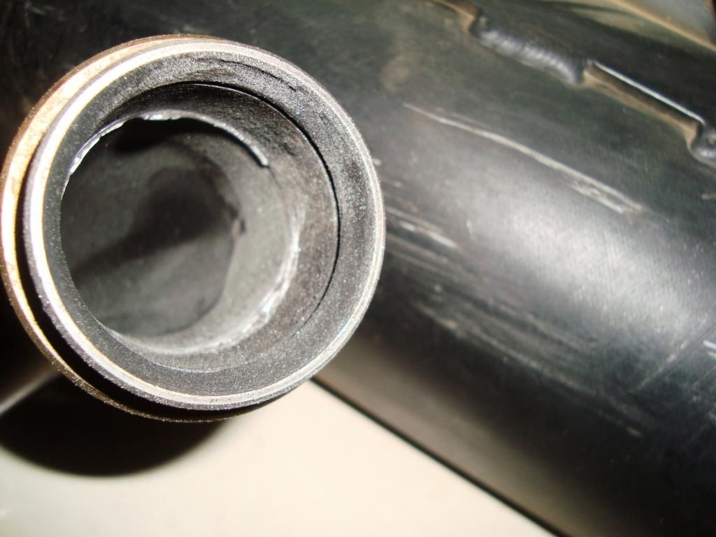

I'd read in another post about excess material left over from welding in the header so I thought I'd check that out and sure enough there was plenty. This pic is after grinding away about half of it.
I went through two small sanding wheeels with my dremel getting it flush and smooth (the way it should have come from the factory). Some 800 grit wet/dry paper finished it and then I flushed out the pipe of all debris.

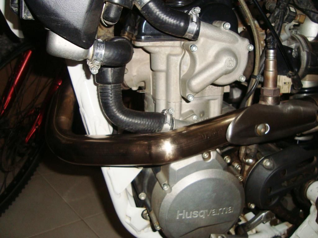

The header was shiny silver colored for about 5 minutes and then turned to this nice gold color after tearing up the road and back.

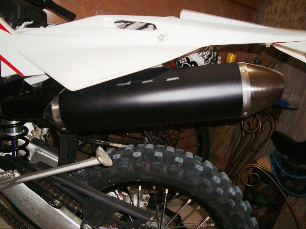

I think the canister looks pretty nice in satin black.
