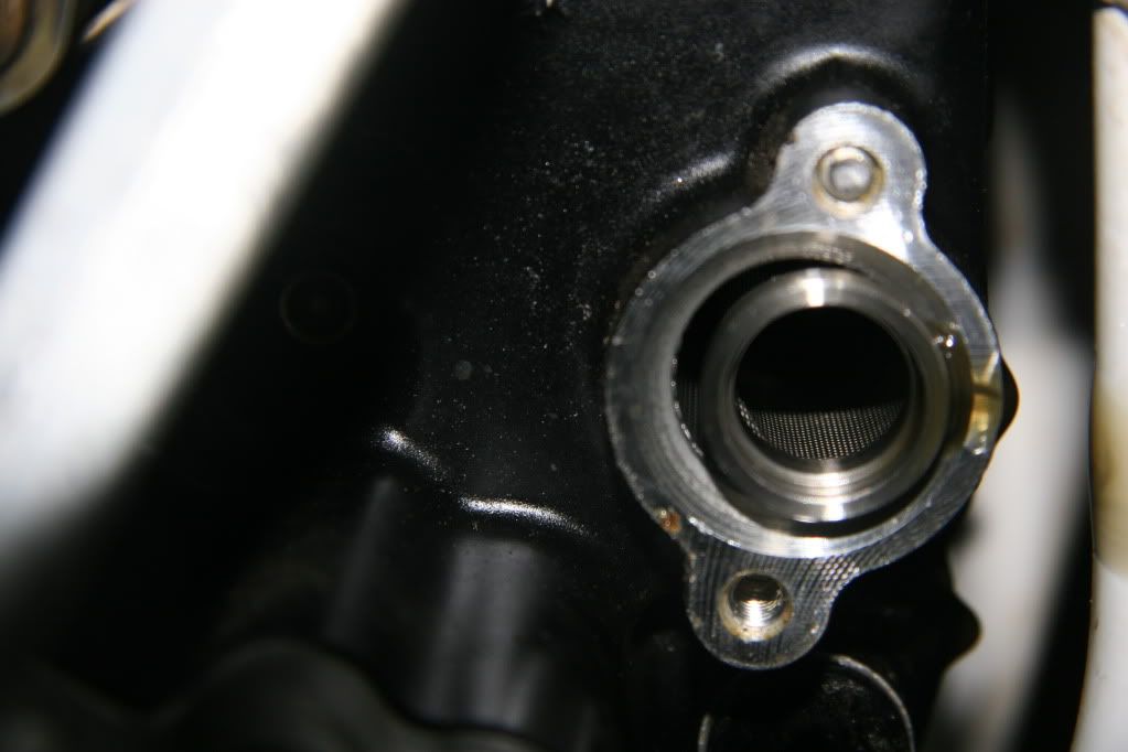

How much am I about to hate my life? Here are some photos of what I'm looking at.
Honestly I am such a freaking idiot. The worst was that moment you hear that snap, and everything just goes loose, and your heart STOPS. F me right about now.
Also, this sticker on my fridge seemed relevant.
Pretty much, how do I get it out.

Call "the guy". He will have it out in seconds. I tried to do it myself to the same bolt on my bike and made a mess of it and made it harder for "the guy" to fix it. It is quiet cheap. Just do a search for mobile bolt removal or mobile thread repair in your area.

I broke one of the front fork pinch bolts, PITA to get it out. Here is how I did it:
lots of penetrating fluid
small dia drill bit into centre of bolt
pushed an "easy-out" (a reverse threaded bit) into the hole
backed out the bolt
This worked for me, I was real worried when I did it but it turned out OK.
Last, after you get it out: install the 7602 oil drain kit and never take that bolt out again.

If you are going to attempt this yourself, pony up a few $$ and buy one of these:
http://www.skygeek.com/ats-1341s.html
It's designed to drill out bad rivets, but it's a great thing to have even if you don't work on aircraft. The way it works is the various inserts center the tool on a hole, counter sink r rivet head. Then the drill goes exactly down the center of the rivet or screw or whatever. AFte you have a hole in the center of the bolt, you can use an easy-oout to extract the broken screw.
I've drilled out a of of rivets with mine, but I also use it for centering screw holes in door hinges.
Left hand twist bits are another handy thing to have.

If you are feeling confident you could probably get this out with a fine centre punch ,just put a pop in the outer edge of bolt then tap the punch at an angle to the bolt so that it produces a turning force if the bolt is not rusted in or seized it will start to turn (make sure you hit it in anti clockwise direction ie undo the bolt).may save you a few dollars.I have done this many times on all soughts of applications especially when high tensile bolts are used.
easy outs are crap! they can cause alot of headaches if they snap. Google Bolt Removal or Thread Repair. Trust me, get a professional. Cost me 110 bucks to get it out and he had to repair the thread, IF I called him from the get go, it would have cost me $40 with no thread repair and straight back in with the same sized bolt. I'm no backyard boy either, I am a stainless steel fabiractor by trade and use taps to thread stainless every day, Alimunium is soft, one slip and you will be calling the professional anyway.
If you are really worried about these bolts coming out ...just use some that thread tape on them ... It will not lock the bolt in place for next removal and it will prevent the bolt from backing out all the way .... IF it was too get loose, the ~worst that will happen is a small leak because the bolt should be held in place by the thread tape ...
I did a bit of googling and oddly enough many Australian shops showed up. :)
Yet another idea would be to call auto repair places and auto parts stores, they are everywhere.
There's always more than one way to skin a cat , so dont get too worried the worst case senario would be to drill out and fit a helicoil insert again cheap and effective.Being an aluminium casing it would be unlikely to bind like stainless does,easy outs do work if used in the right application .Just ensure you centre punch the bolt in the centre so that your drill is centralised and use the correct size drill for the easy out.
I agree with Rusty Nuts. Been there, done that many times on the job. Try the small sharp punch to back it out. Don't mutilate it so bad that you can't drill it in the center if needed. You'll know pretty quick with the first few licks if the punch gig will work.
