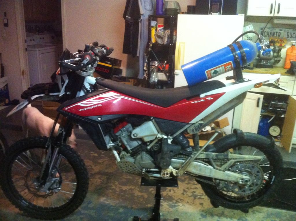

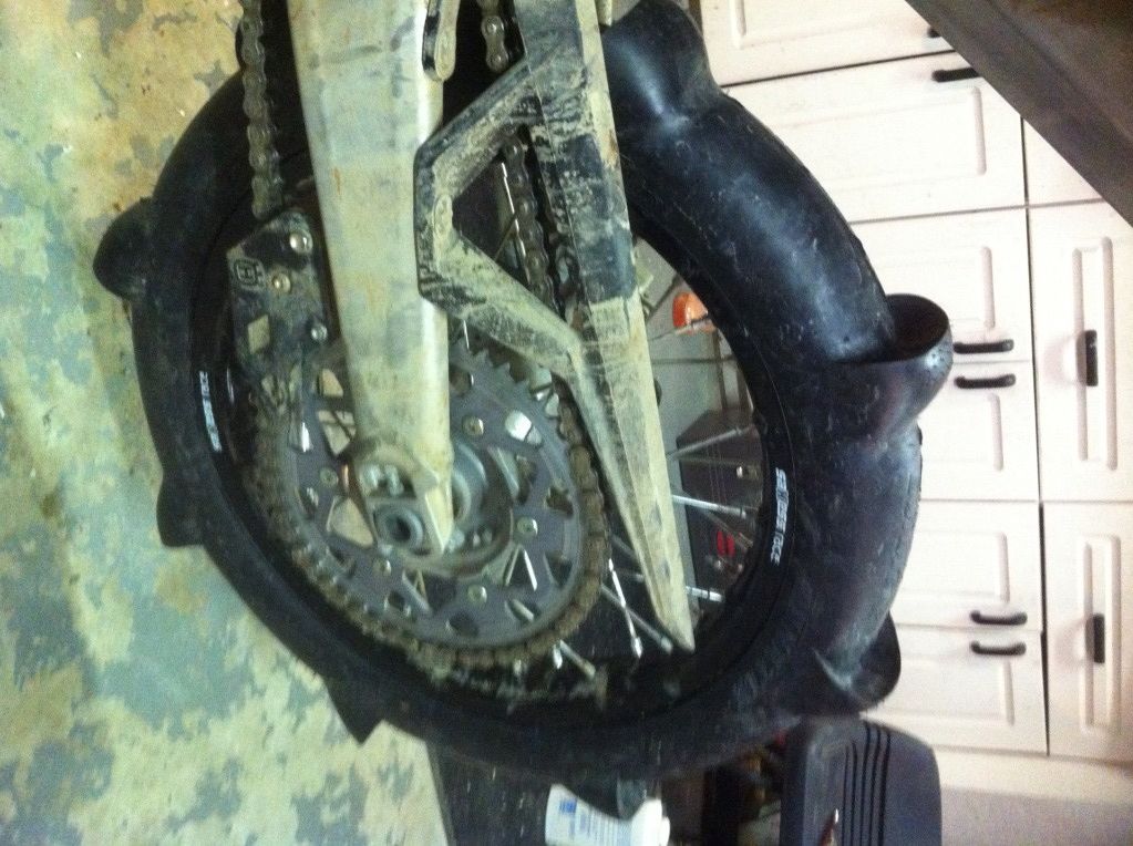

I bought a Dunatik Paddle for my TE449. Worked awesome. I think if you look through my posts, there is a photo of it at Little Sahara....
Ok found a pic
