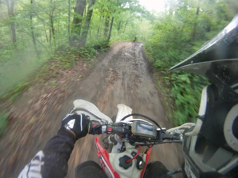

++ on the Garmin 62 series. Mine literally lives on the 511. Its literally spent days out in the rain and has been totally submerged several times...Just can't kill it.
If your intention is to use it for regular navigation the small screen can be a pain but I mostly use it to collect tracks and get me out of an unknown trail on occasion. When the going keeps getting tougher it's nice to have a look and know that there is some sort of road just a few hundred meters away.
Chilly White found another great way to mount your gps, regardless of model you choose. Ty and I both use this method. It yields pretty nice flexibility and moves when you go over the bars.
http://www.enduro360.com/2013/12/22/products-tested/flexx-bars-gps-ram-mount/
Hmm, might have to try that arrangement. I currently have mine setup so the gps (Montana) sits between the cross bars of the Flexx bars.
Not sure if related to mounting location, but the screen died on it a couple months ago (the digitizer cracked at the edge allowing moisture under it). I don't remember landing on it, so who knows.
More power to you guys who can actually read a GPS on the bars, underway or stopped off the side of the trail. I usually just carry it in a jacket pocket along with some cheaters.
I dont see how that works at all. I learned a long time ago you cant mount GPS's on the left side because when you compress the front and the front brake like comes up and over and tears it off.
Mine is a little different than that, I use the 3" ram mount which brings it up and out a little longer and my cables slide under with no binding at all.
Easy enough to adjust while mounting it. I heard the concern when I initially installed mine as mine can appear very close. Compressed the forks and noted where the cables went. While the mount rotated forward would give me a better view, it's positioned to not snag and has not in use. If it did, I could rotate 20 degrees either side with this style mount, and avoid completely. The only negative to this mount and where the GPS is... It's too tight to allow a bar pad, since I need to rotate the device on attaching to the bar.
