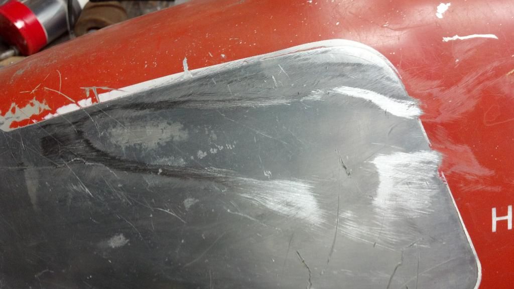

Using a paint stirring stick (Thicker one, free from home improvement store), I wrap 120 grit sand paper around it and sand around dent area to highlight the dent to remove. The stirring stick keeps the sand paper level. You could also spray the area with a light coat of dark grey primer/sand area to highlight your dent's low or high spots.

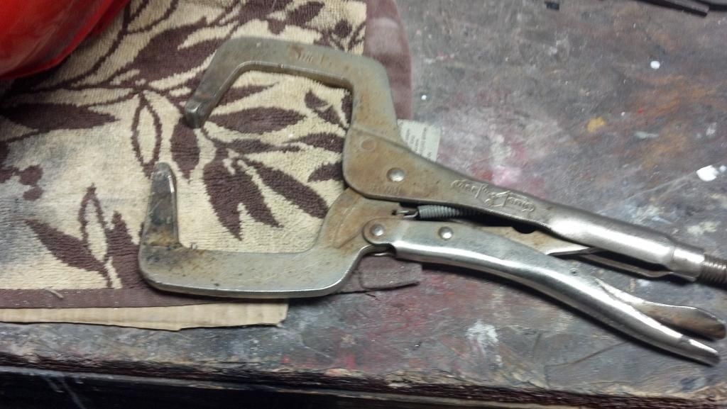

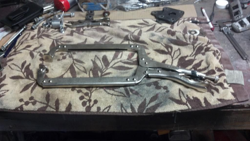

These are some of the tools I use. 18" long reach swivel, vise grip clamp (Good for pushing from behind and leveling dent). Another set of vise grip clamps with rounded ends (Good for removing creases/bulls eye dents).

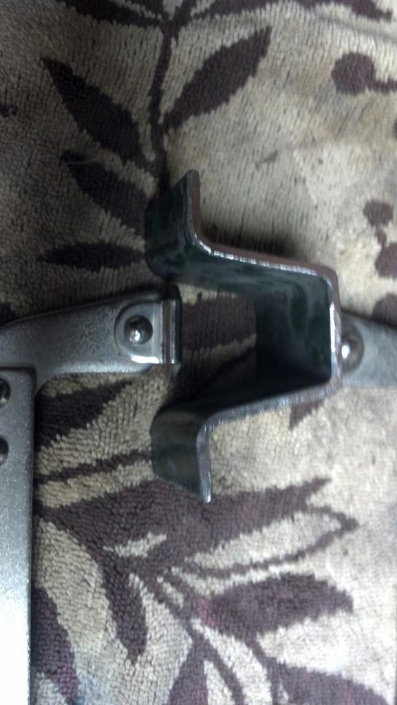

I use a piece I cut out of a farm fencing brace ( It enables me to clamp and push dents out from behind while keeping a level surface that is existing).

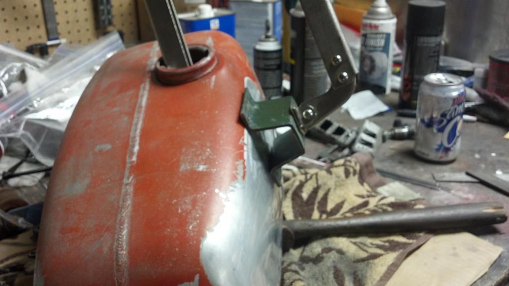

First pic is fencing brace and swivel clamp in use.
Here is the tools in use and you can see through metal fence brace how much you are pushing dent out to overstretch metal.
This one is good for pushing dent out and leveling metal flush.
This one is good for removing creases.

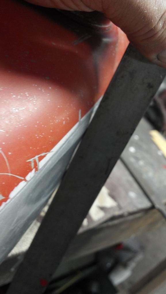

Using a straight edge, review your progress with each pass of your clamp. I also sand each pass, with the paint stirring stick/sand paper, to re highlight dent area, as it's being removed slowly.
Step 4

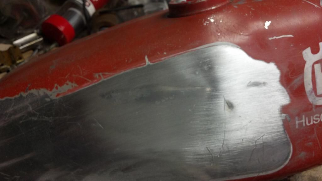

This shows my progress after about 15 mins of work and sanding to re-highlight my progress. I am after getting the whole dent out first, then I will come back for little dimples, etc... I use a ball bearing duct taped to my saddle clamp for dimples and little creases.

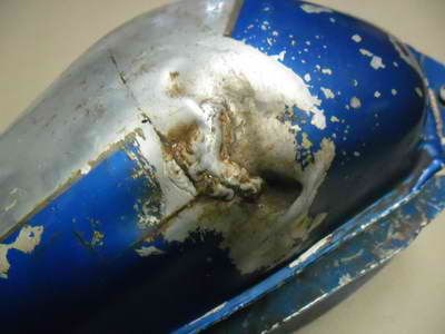

I had one tank, someone tried welding and burnt huge hole through front. I cut bad area out and welded in new section.
