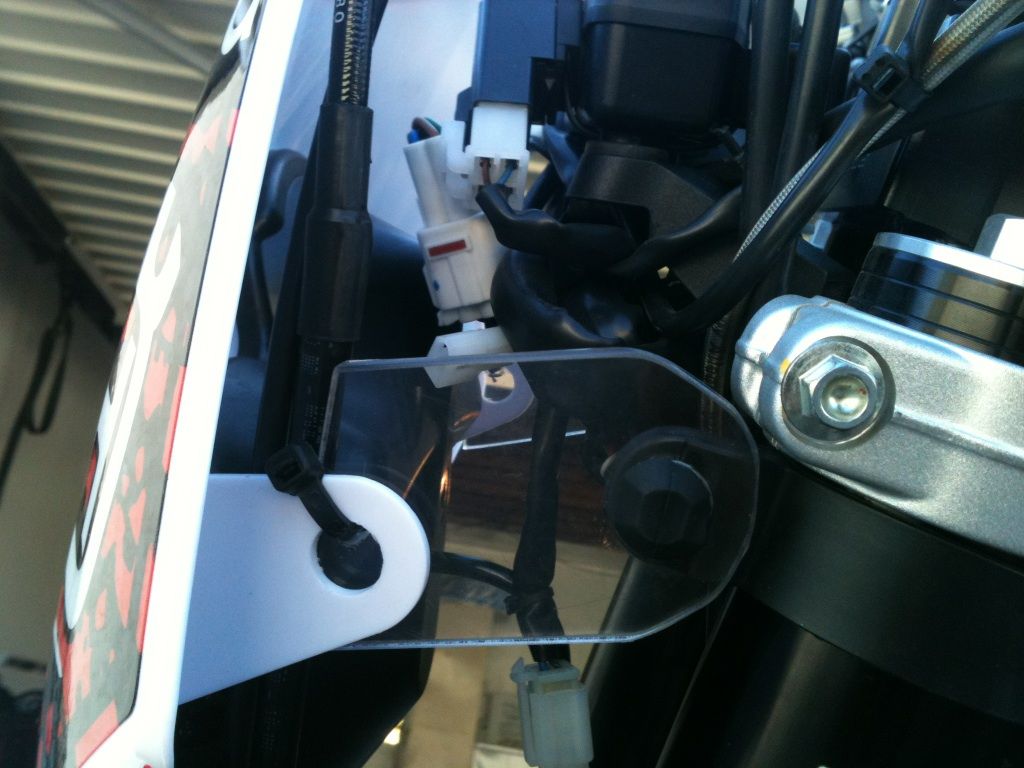

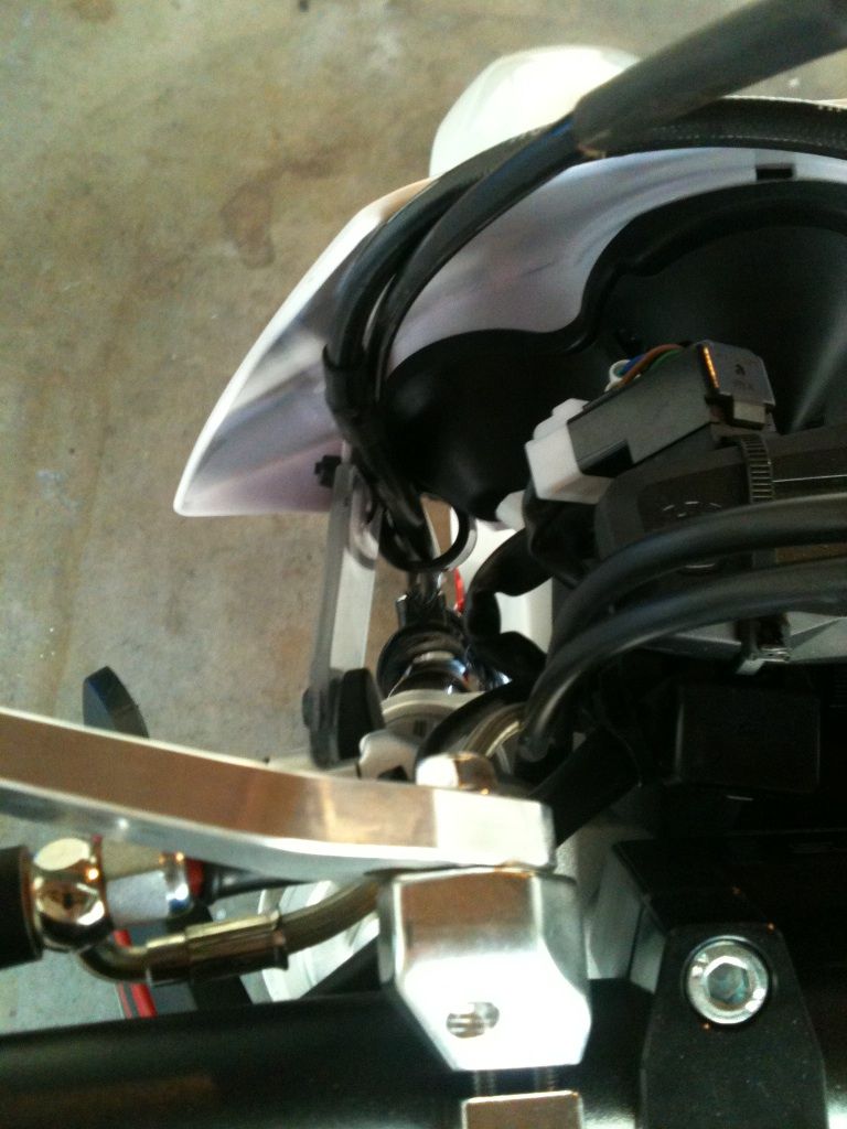

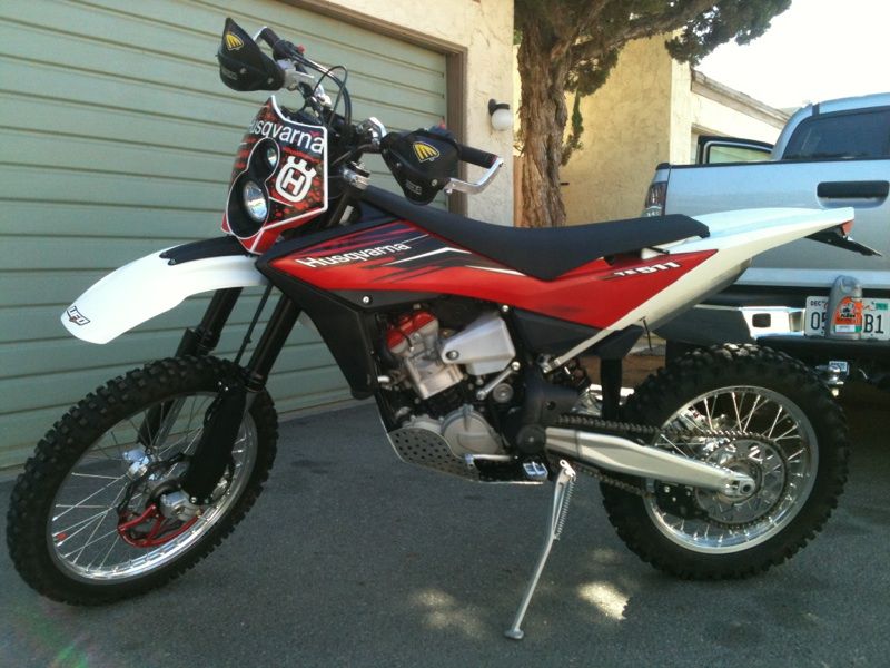

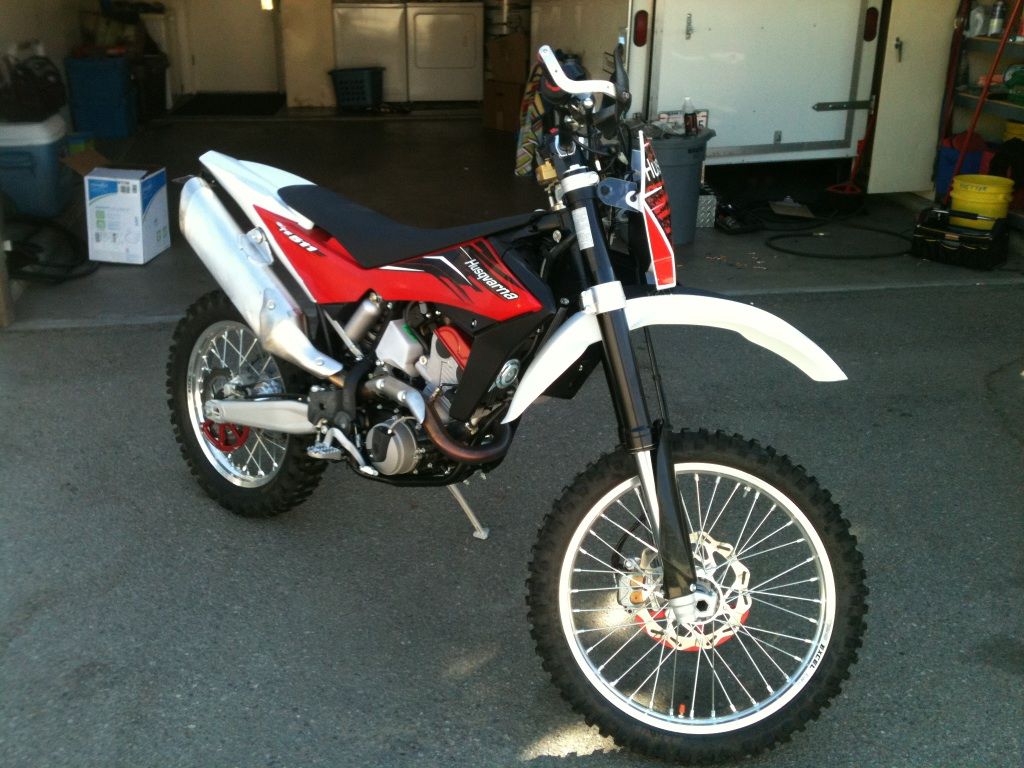

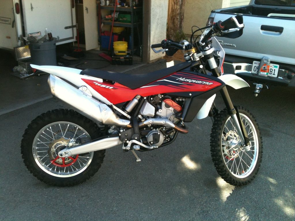

Hey fellas just wanted to share how I got rid of my stock front fender and head light. I didn't totally dislike the stock stuff to justify the switch without a good reason so when a fall i had a few months ago left the stock headlight frame busted enough to warant a complete headlight I decided to go after market. I bought the Trail Tec H2 halogen light with husky plugs($109.00) and the husky graffic ($9.95). The front fender is for a TE 310 wich is a straight bolt up and perfect fit( I couldn't figure a way to use the stock fender without making the headlight tower over the bars).When I received the light I immediately fitted it and discovered I would need to tidy up the wires high and tight then make some brackets to move the lamp away a bit from the heat of the light housing "after I test road bike I could smell the wire harness was getting warm after 5 minutes".... Just finished installing today and I am very pleased with how well the light fits and appearance. Light seems very secure and should take an xtreme front/side impact like destroyed the stocker ..... Here some pics how I did it....
Looks great !
Built the brackets out of lexan, virtually indestructible . Can easily unplug light wich might come in handy with my none D.O.T. Version :)
Holds the brake and speedo cable in place very nicely unlike the stocker.

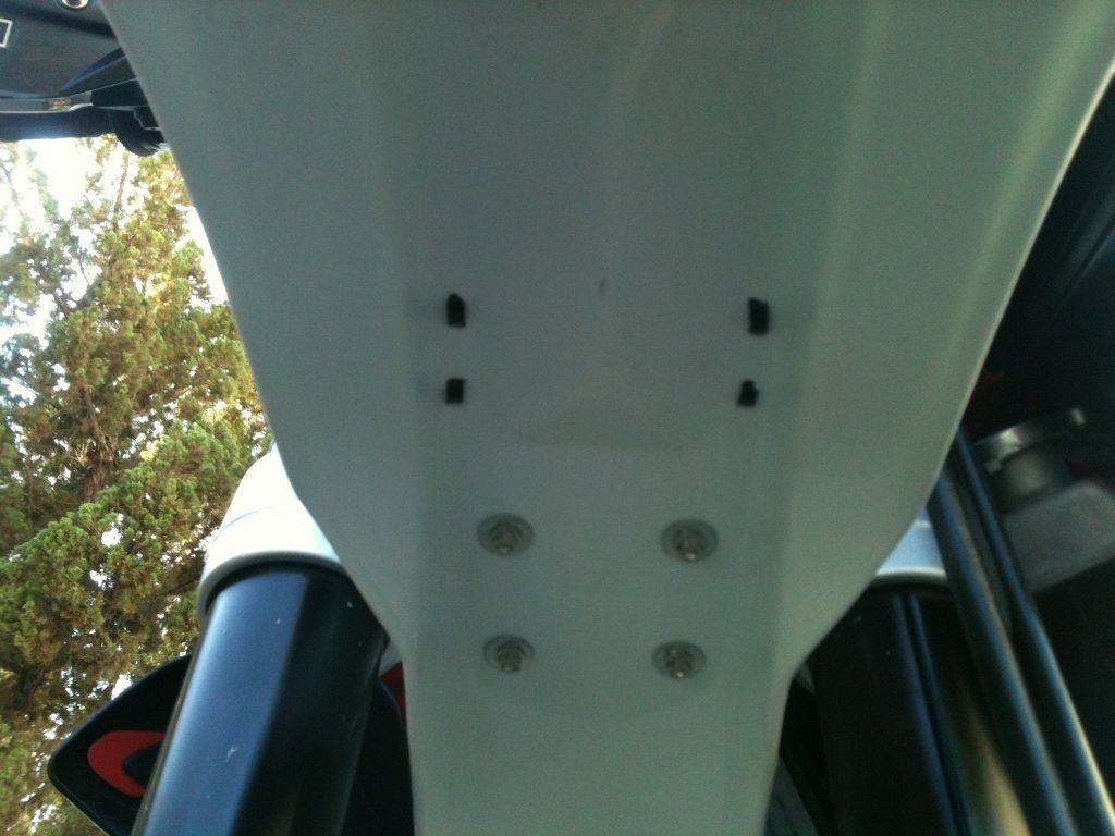

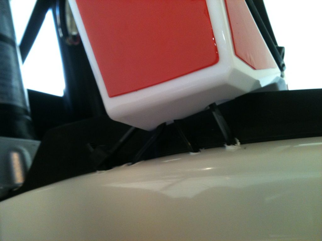

Zip tied bottom of light threw fender..... Light beam can be slightly tilted with zip tie adjustment...
