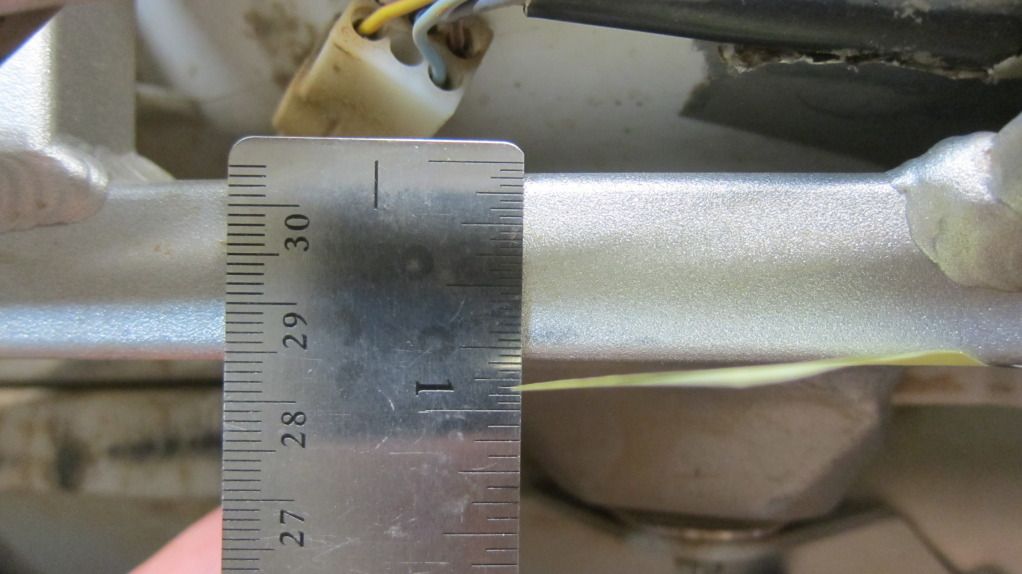

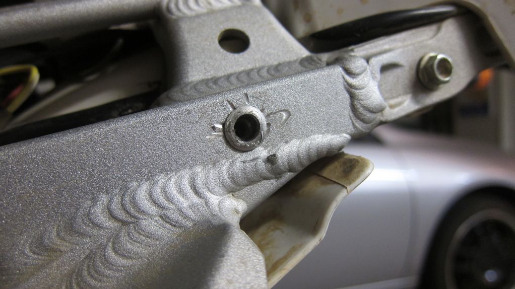

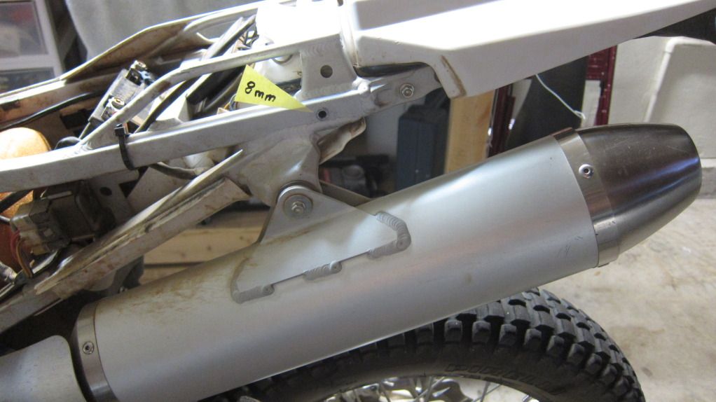

It receives an 8mm bolt, and secures the rear end of the side plastic. The threads are destroyed but the insert remains solidly embedded in the subframe.
Looking straight down. The insert/bolt does not emerge on the other side of the subframe rail. The insert must be pressed or shrunk into the rail wall (?)
How can I fix this? Thanks.

First are the threads stripped? or is the insert just spenning?
If just spinning find someone with the proper tool to resqueez it.

Its M6 not 8 by they way .​
Thanks DG Harv Serv. I checked today-it's 5mm x .8 actually. But thanks anyway I would have blindly been seeking out 8mm fixes! :cheers:

George thanks so much for your generous offer, but I'm in Santa Clarita, and don't have a truck or trailer. The threads are stripped. The insert does not spin. Do you think I should try a Helicoil fix?

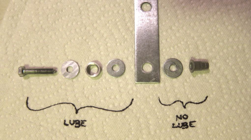

Thanks for your response, Wilbur. I have some rivnuts on order. If those don't work I'll give that a go. :thumbsup:

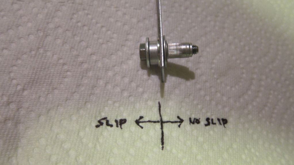

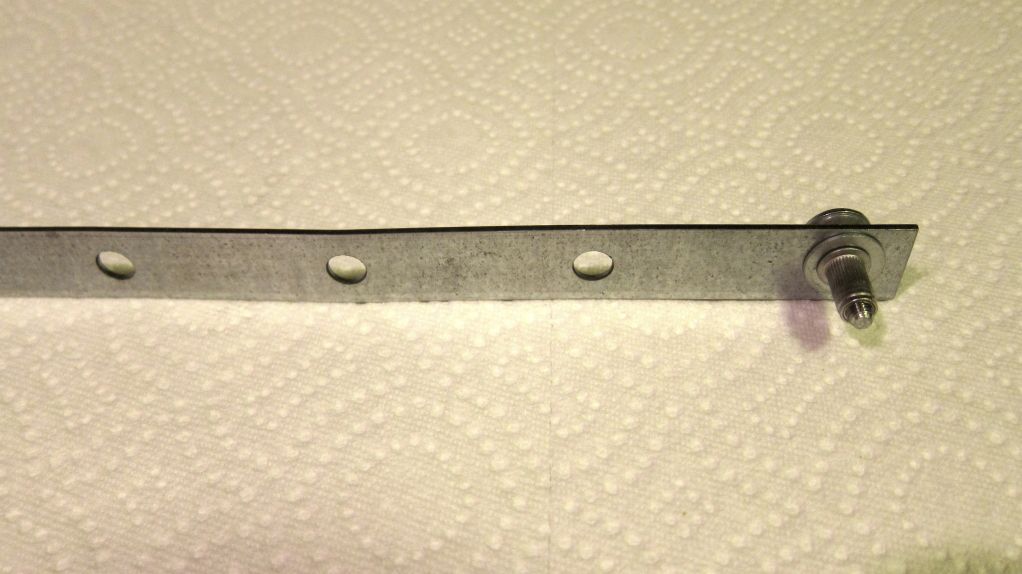

I've read that I can install the rivnuts with a DIY bolt/spacer/washer rig. Anyone else ever do this?
If you can't hit George for the proper tool, I have given them a couple whacks with a pin punch to spread the outer ring to hold on. George has then fixed it with the right tool after when it started to spin again. Looks like you got it done....
