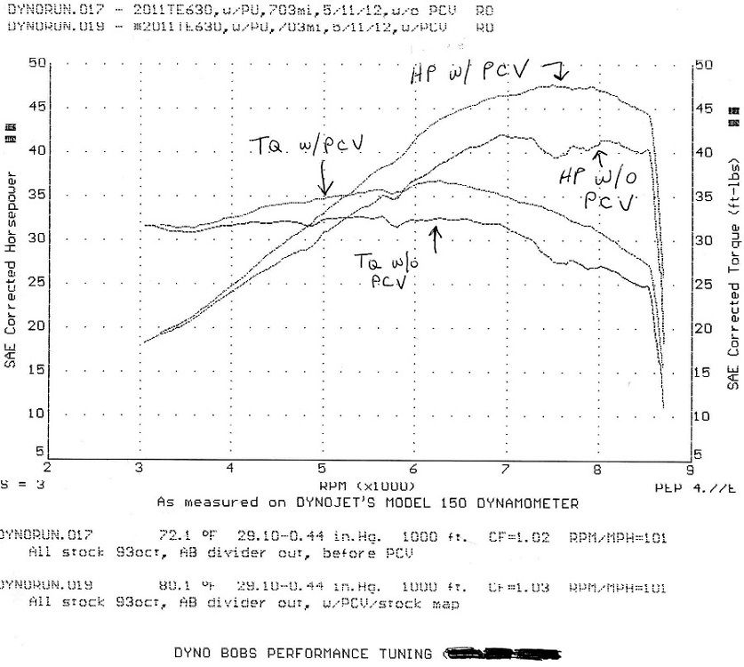

If you are not adding fuel at high rpm/high load you're most likely very lean to the point of being dangerous. These bikes are very lean on the big end with just a PU plug, I think mine made 37hp with just the PU, and made 47hp with proper fueling. How old is your battery? I suspect it is weak, mine has started many times right at freezing. These bikes actually have a generously sized battery. I must be getting old, I can't imagine wanting to go 85mph on this bike... .

I like my Power Commander but I achieved the same results on my buddy's bike with just iBeat adjustments. .
I have a Power Commander too, I like it. Maps are available from Power Commander, Zip Ty and I don't think Bob has not published his maps for easy download but you can look at them in another of his posts/threads. The JD I had was a pain in the butt to tune as its located under the seat and you have to tune by seat of the pants, I never got it right.
