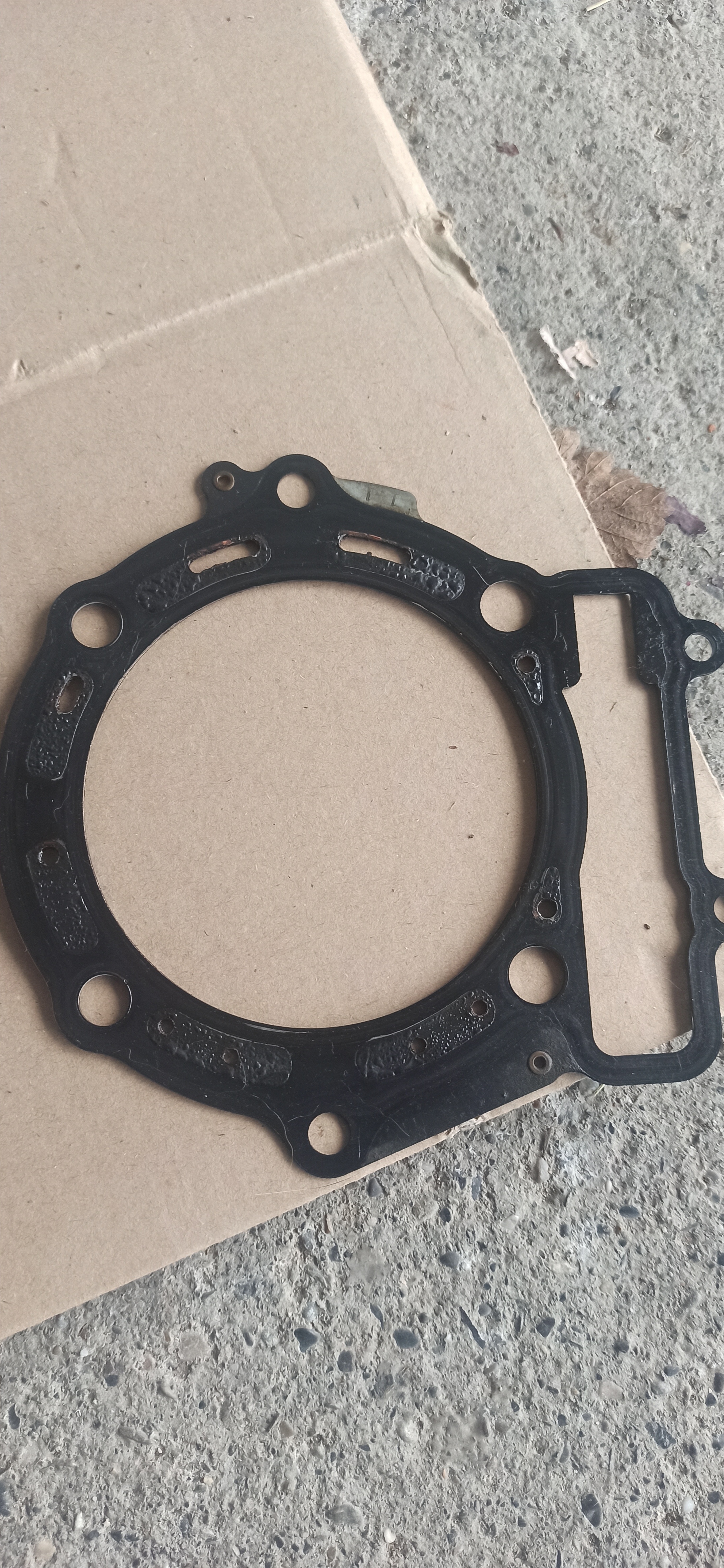

Hello all, Sure 99% my TE630 head gasket is broken, very very hard to cold start, spark very wet (a new one become wet very quickly and it do not smell gas stronger). At cold start (when I success after 5min of struggling or by being pulled by another bike !), loud white smoke (only during 5min), expansion tank spits a bit of coolant, level of coolant to refill every 3h (happy to have a coolant tempetrature screen on the my handlebar to know if level to low). Despite this, if it starts, all is fine in term of engine feeling the whole day ! I seek for the good PN and there are 3 thicknesses: 1.0 1.1 and 1.2mm, but same PN 8B00H0937 Why 3 thicknesses available and how to know the good one for your bike? Thanks

proper reason for different thickness is piston to head clearance,repair manual calls piston in bore 0,5mm is 1.1mm gasket p-i-b 0.6 is 1mm gasket p-i-b 0.4 is 1.2mm gasket. With bigger engines its usually effective to target 1mm piston to head clearance. For both economy and power. If rod gives,it doesnt make difference if there is 1mm or 5,piston wont stop before head...
I will measure my current head gasket to be sure ! By dismounting the engine today I am now sure of the issue ! Nice pool of coolant on the piston ! Hope the rings are not damaged due to this coolant stagnant here.. Blisters close to every holes...
