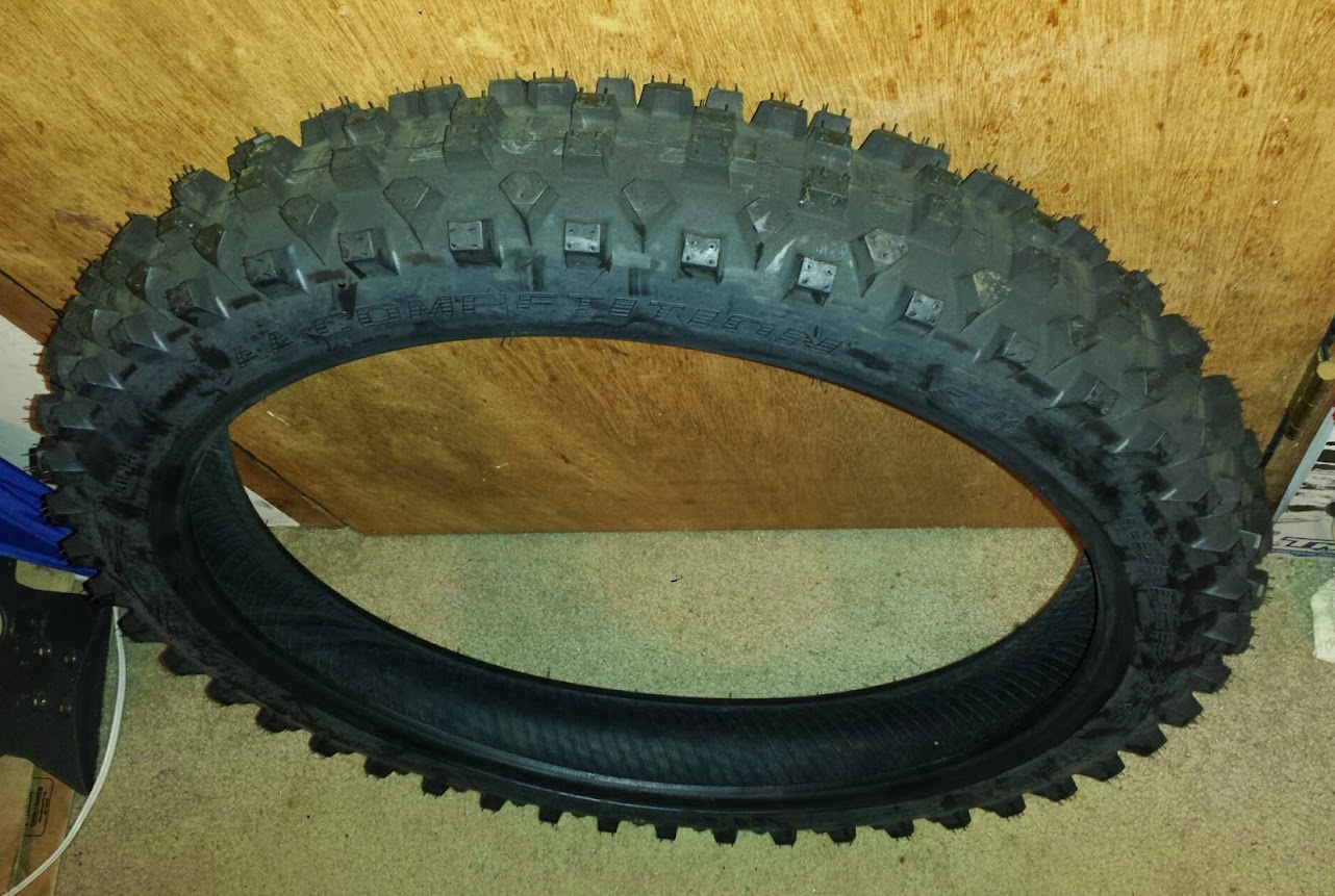

Just got a Golden Tyre front (GT216AA) in form the good people at ZipTy Racing to try. Have not mounted it yet. Some observations...
- Seems stiff compound
- Say AA Competition on the side so I'm not worthy :>)
- Also says FIM on the side but the knobs seem tall
- Says DOT on the side
- Is a 2 ply nylon tire
- Is huge and wide 90-100-21
- Looks like a supersized Pirelli Scorpion
Not sure what it is getting mounted on, good chance it will be my YZ450F. Will report back. Heard nothing but rave reviews so far so looking forward to it.
