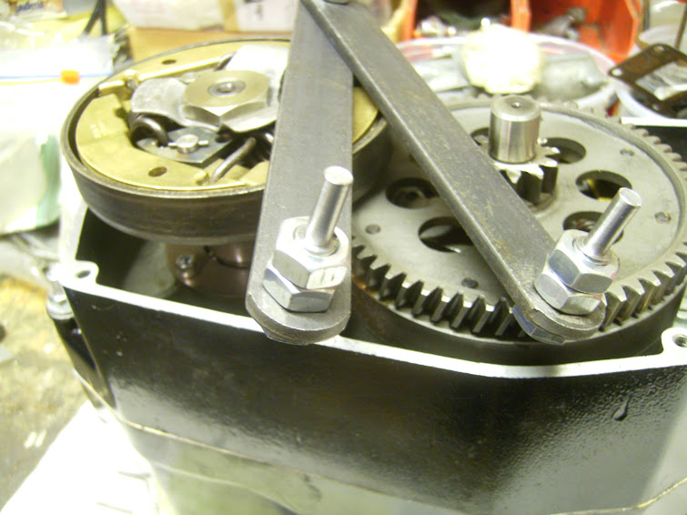

    You will need to hold the first gear clutch to be able to undo the nut.
    I made this simple holding tool ....
    You will need a 32mm socket and a 24" strong arm
    When the nut is undone ......
    You will need to adapt a puller similar to the picture below. Mine was a cheapy from ebay. I had to machine the slots in, much closer to the centre.
    Make sure the three M6 bolts go through BOTH parts of the central hub.

    Thanks for the advice guys. The piston is frozen so no special tool needed. That nut came off real easy and I used a 3 jaw puller to pull the clutch housing. It came off easily too. I did not see any holes in the clutch housing for those 6mm bolts to go into either. When this motor is finished I'll need those tools. I'm thinking I'll need to pull the other motor apart to replace the seals and check out the transmission. So I'll need those tools. Ha! Thanks grouty. New gaskets as well. Alas there is no free lunch! What are the threads for the fly wheel puller? I've got to get one to finish the disassembly of the motor. And a bigger bucket of diesel. Thanks stormer254. Pulled the motor from the frame after work today and will take the frame to storage .The blue paint on everything is latex too. Looks like I have 5 husky motors to finish, hell looks like I'm in dartyppyt' garage! Minus the wicked bikes!
