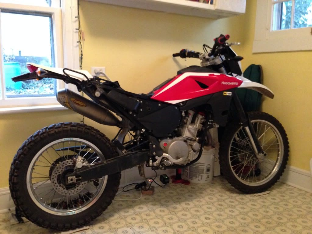

I'm in Virginia, and have a TE630. Regrettably the house I've been in for about 5 years hasn't got a garage (sure miss it) and my basement, owing to the stairwell/angle to get in, is not an option for getting the bike in. For the past 5 years my bikes have sat outside under a cover (chained down, etc. in a covered walkway tight next to the house.) Anyway- I've never used a tender, stabil, or anything and they always fire right up and work fine.
Now this year is different. I have made a way to get the bike into the house- it's in the corner of my kitchen. :) This winter I've got to get the clutch basket out to do the cup washers (common issue on the 610/630's), replace steering head bearings, bleed brakes/clutch, etc., etc. Also the first time I've tried the Battery Tender (decided to start as, owing to the rather sh*tty wiring routing of the bikes, I'd had a fray/drain- since patched- but charging isn't quite up to par...another thing I'll re-examine while it is in for the cold season.)

Here 'tis. Now your wife raises the right consideration- as others can attest there is a slight gas smell but us bike types tend to love it. :) I can get away with it...my house is 100 years old and not nearly as efficient as it should be, so the house vents more than it should and there's only the slightest smell in the kitchen and nowhere else. With the heat cycling it clears up what little smell there is. The other thing in my favor is that the kitchen is the only room in the house I've not renovated, so it's got a sh*tty old floor, etc. and not really worried about the occasional miss of the drain pan/mat.
