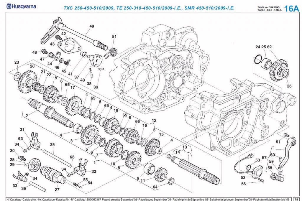

So, I am lifting my TXC510 2008 up onto a motorcycle stand and since I'm old and weak, I laid the bike flat on the stand on it's left side and torqued on the shifter. When I got the bike finally on the stand, I noticed that the shifter was at an odd angle and went to move it and it just flopped all the way down....as if it wasn't firmly attached to the shift shaft...well, it's still firmly attached...but the shaft seems to move without any resistance. The bike is currently in gear but no matter what I do, I can't get the shifter to do anything as it now seems to be attached to nothing. How is this even possible? Is my TXC510 that freaking fragile? I am super worried that I am not screwed. Please help.
Someone who has transmission experience might be able to give a quick fix, sounds like something slipped off/over/etc and might be able to be fixed easily. Here is a 2009 diagram, hopefully, its the same as your 2008.
sounds like the shift shaft. I had 1 fail on my 08 TE250 and the next year my buddy's failed on his 08 TE450. It's #49 on the dia. Not too difficult to replace, gotta remove the clutch basket to get to it. Good luck
