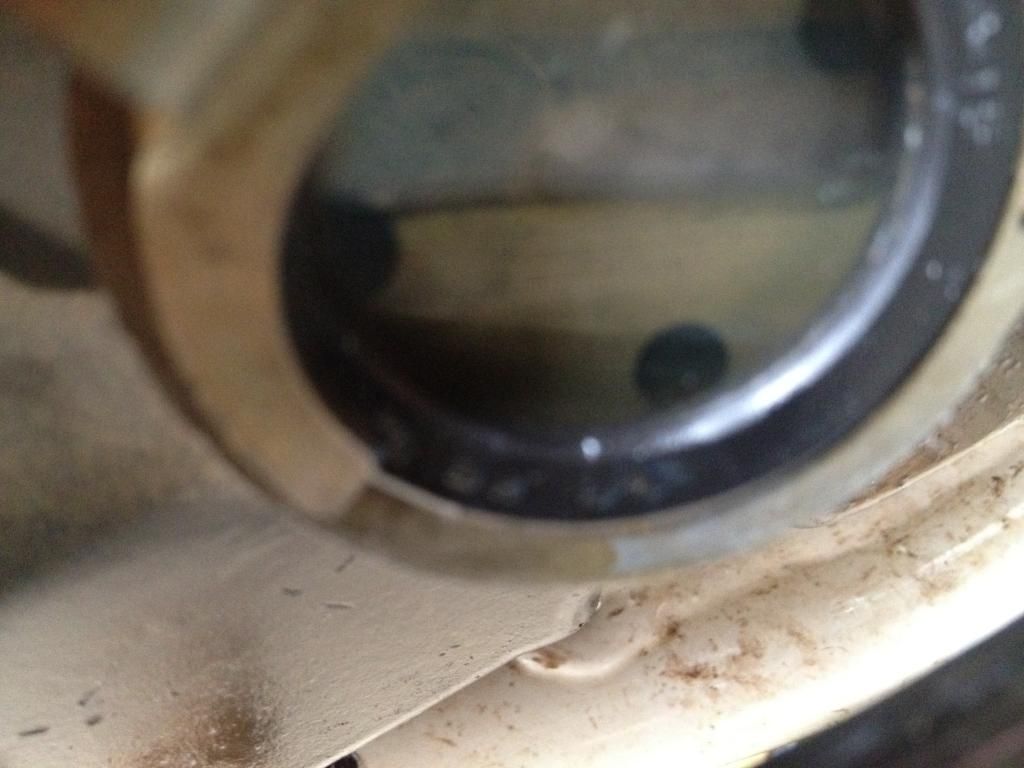

After i did the second oil change with AGIP oil (expensive)...it turned to white..since i had already changed the oil three times, first with clean AGIP then with the old oil and third time with AGIP again (all three times i made sure the filter was changed too)...and when i stopped it yesterday night...
so this morning, the first thing i did was check the oil glass..the oil was transparant as it should be...then when i ran the bike for a minute i see the white foam come back.....so to asnwer ray_ray the oil did settle back to normal...but when i start the engine it turn mayonise in minutes....

The reason I brought up the oil changing in color back to black, was because someone else had an issue such as yours and it was just the engine churning the oil and making it foamy and white ... He'd dump the oil quickly after running the engine and it would change back to the color black in a short time span ...
Use some cheaper oil if you are gonna test for water again ... no point in wasting that expensive AGIP oil ... About any oil will work in this case ...
When my water pump oil went out, there has no chance of missing the milky oil in the sight glass AND it just took a few minutes for the oil to turn the wrong color AND the oil stayed milky looking for a long time.

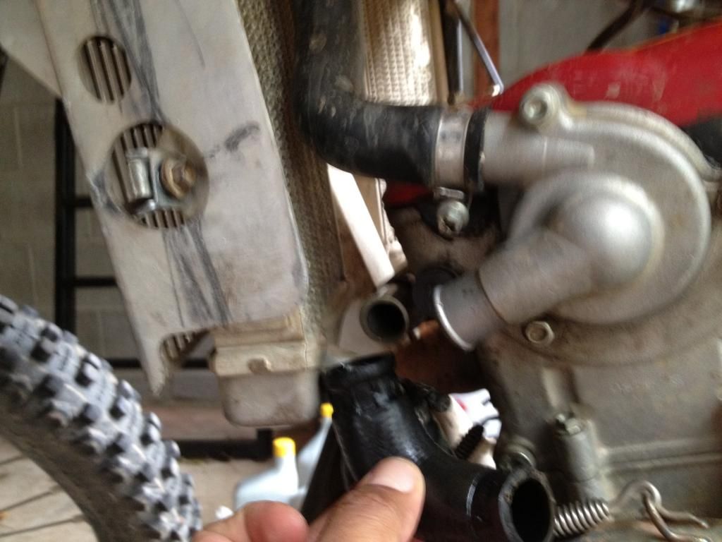

so i am getting there with the oil out of the syste,...i called the local mechanic and he told me to run the oil for longer period of time not for 2 mins and dump the oil...he told me to run the system long enough to get all the water out....in doing so...i ran the bike hot and could see some smoke comming...it turns out i bent one of the radiator holders and might have punctured the hosesthat goes into the water pump....
so i removed it and out came the coolant...which is really slimy....is it the coolant in the hose and the pump that came out...because after maybe a lot of it comming out i checked the radiator and still could see the coolant at the top....so my question is how do i get the coolant back into the same level as in not running low on coolant...and do i now have the flush the whole system...if so how to do it....and can i take the water pump out and see if the seal there is fine and need changing.....
the oil though is still getting murky but if i let it stay for a while it turns back to normal...but since i got the hose out..do i now have to do
1) coolant flush or add more coolant...i have no idea what stuff went in....and what coolant people usually use...
2) do i need to open the water pump and check the seal...and where to buy it from (Halls?)
