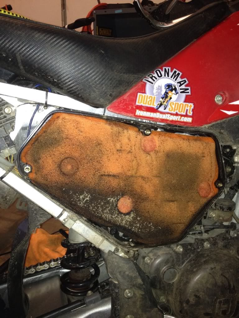

This was from one ride, the Berkshire Triple.

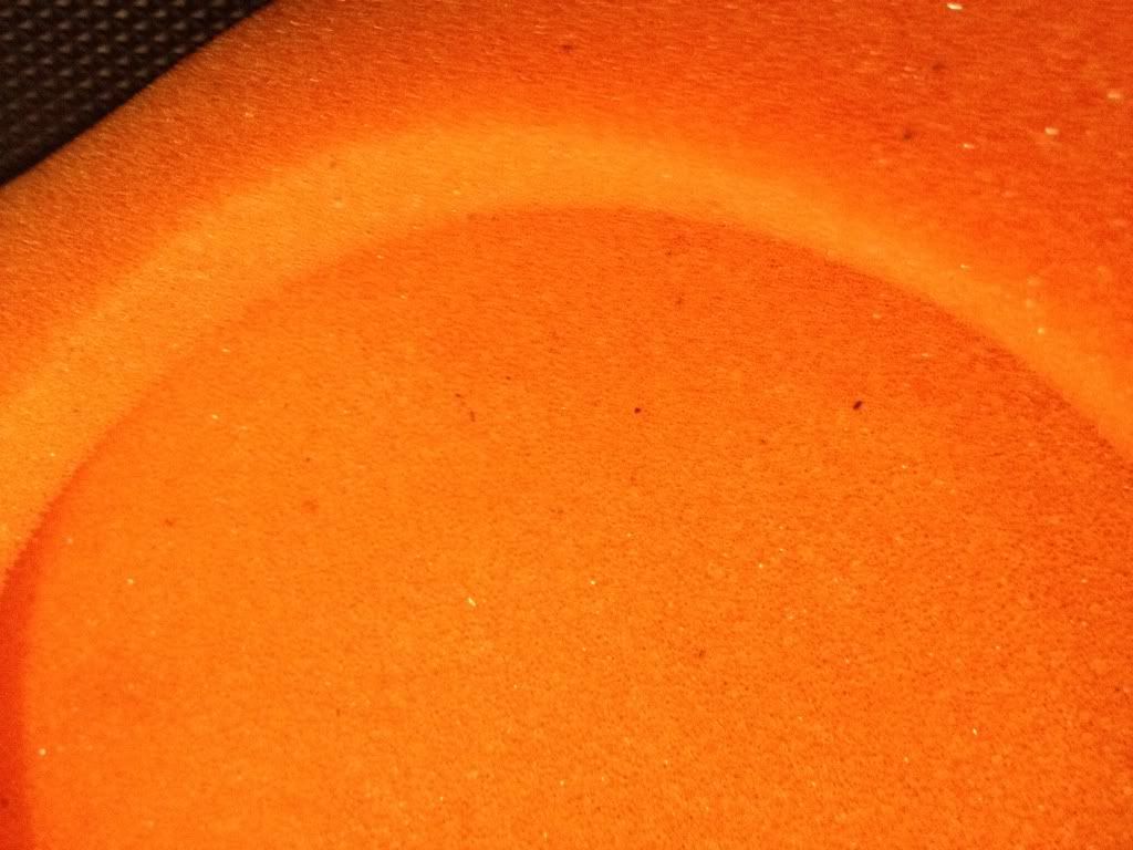

I cleaned it very well ( I use No-Toil ) three or four times. Look very closely at the next pic. The filter is doing its job, but this is so imbedded I can't get it out.
I kinda feel dumb even asking, but would you re-oil it or trash it? Remember these cost $30+ each.
I would re-oil and use it. But before re-oiling I would try to dislodge those particles by repeated banging the filter against a hard surface. Might knock some of them out.

I don't think the pic shows how much dirt is really embedded in the filter, I will hit it with the air hose and see if that helps.

I hit mine with a shop vac, carefully of course.. Then oil it up good.. If it doesn't dislodge with a vacuum it is most likely going to stay.. Even more so soaked in No Toil or oil..
