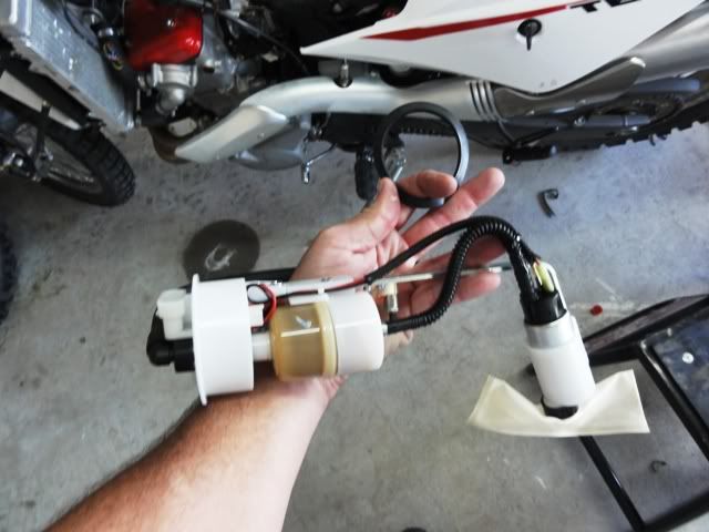

I'm sure there's one in there somewhere... Just remember to hose-clamp whatever you install well, it's ~60psi.
Here's a picture of the fuel pump assembly out of mine. Looks like it's filtered to me.
Thanks Rsquared I'm glad to see that. But weird thing is Husky doesn't list a replacement filter p/n or specify replacement interval. Do you remmeber if that big inline filter looked to be removable from the pump assembly? I hope we're not forced into buying a complete $400 pump instead of changing out a $10 dirty filter.

I don't believe it was designed or intended to be easily changed. As large as the discharge filter is it'll probably run the life of the pump anyway. Most likely, if and when mine fails, I'll probably end up doing a garage fab using one of these pumps and a universal filter.
http://www.ktm-parts.com/FP-HUS.html
I've been trying to find a suitable tank sock but found nothing online. I'm taking mine to Africa and I'd prefer not to have to insist I put a stocking over the pump or filler :)
