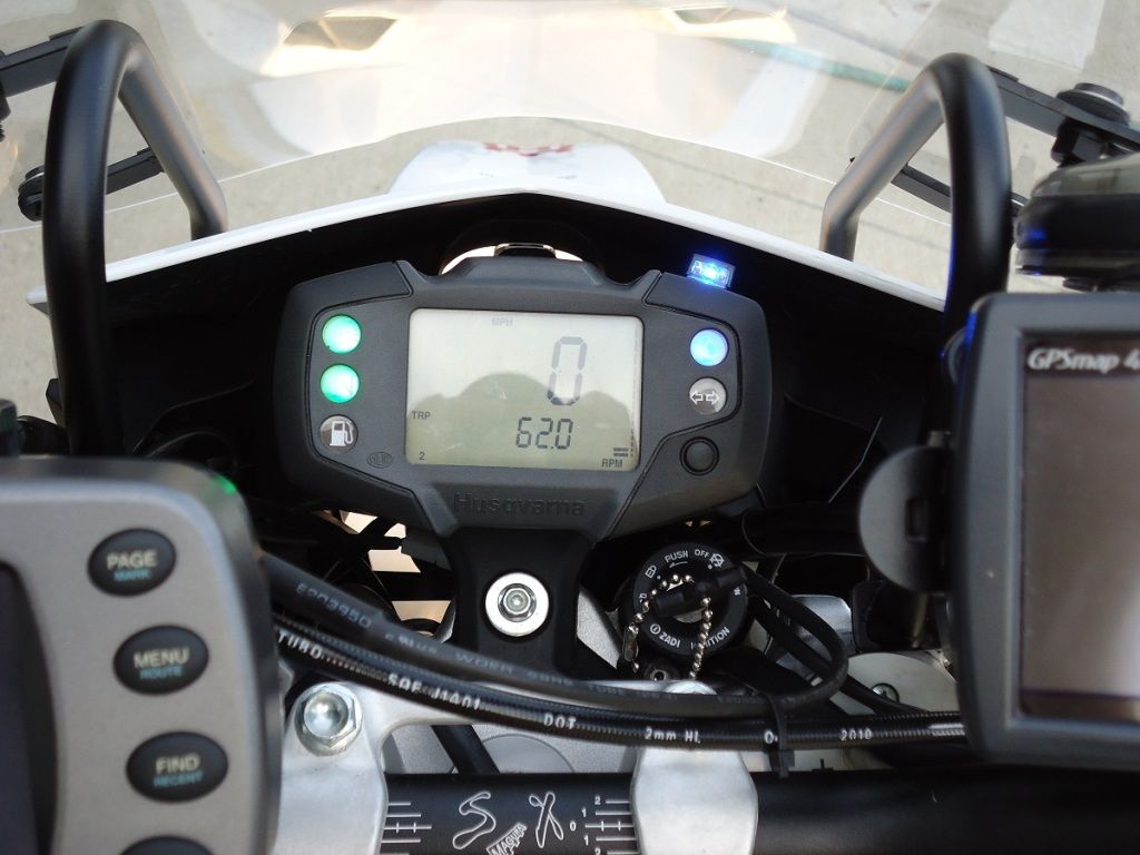

Since you can't troubleshoot when its working, I took the bike apart today and permanently installed a fuel pressure gauge up by the speedo and a small LED light hooked to the fuel pump wires. The next time it does it I can look down and verify that the pump has 12v to it and see whether it is making fuel pressure. BTW, fuel pressure is 45psi when primed and running.
T'd into the fuel line. The line has a hard plastic tube inside the rubber line. I modified the T that came w/ my Harbor Freight fuel pres check kit to fit tight into the fuel line and cut out a piece of line equal to the length of the T fitting. Didn't take pic of gauge yet.
LED on top of speedo.
