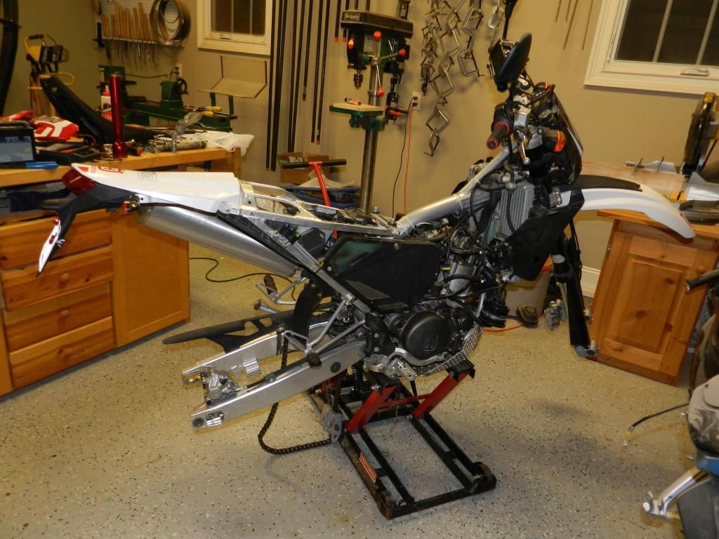

Thx, after the TAT I will be about 500 miles over the service recommendation, so should be no biggie. Bike is being prepaired and really don't understand why some complain about these, everything still looks new and in perfect condition. Some common sense things not in the service manual, make sure the counter sprocket is removed, cleaned and re-assembled with high pressure grease at least every 500 miles and don't adjust the chain as in the manual, or per drawing on the swingarm.:eek:
Pic of bike being prepped.
