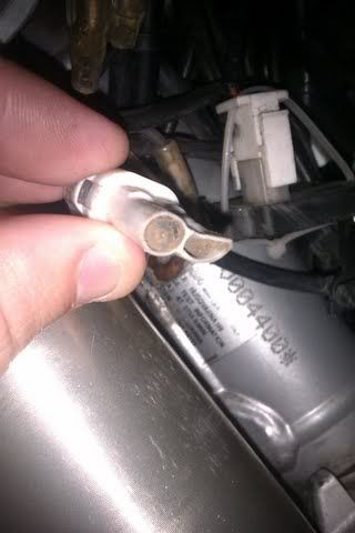

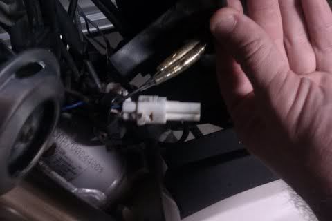

Getting ready to replace my standard dash with a trailtech, and found a plug that was pretty badly damaged, and not connected to anything. Was wondering if anyone knew what it was? Is sitting next to the speed sensor wires, then runs under the tank.

I am not sure what the dead end plug you have is, but I figure it could be one of the resistors for fuel level current limit or one other, I forget. Since your frame is silver, I am assuming you have an 06 or 07 year bike?
That dead-end plug might be for installing the on/off switch for changing between SEL1 and SEL2, maybe, I'm not an expert on it.
It is an '07 so is carb'd.
It can't be fuel level as mentioned in my previous post, there is none on the TE450, I was thinking about my TE610. So rule that out.
I have and 06 and 07 TE450 here and just took a look at them. The wires are blue and pink. The cap is an empty plug cover, there is nothing in it. So it does nothing for you but keep the plug clean.
Looking at the schematic drawing, pink and blue in the area of the headlamp and speedo show part 29, "Scroll". This might be a connection for a remote handlebar speedo pushbutton to change the display, the same as the rubber button on the speedo. I will have to look at this more and try it. The pink wire goes to position #15 on the speedo connector. Blue is ground.
Adjacent to Scroll part 29 is part 28, "Velocity". It is the connection to the speedo rotor sensor for speed input.
So you do not need to worry about the damaged plug cover, no harm.
