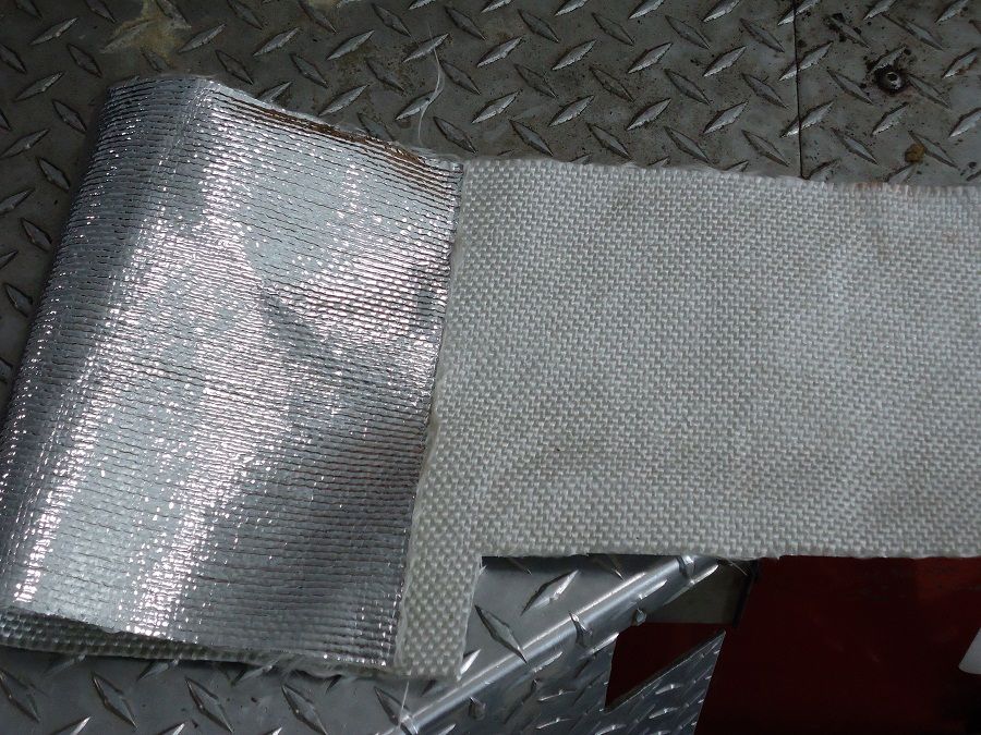

I wrapped the fuel line in heat blanket while I had the tank off.

I did the fuel lines and most of the rubber boot part of throttlebody. Cool air and cool gas help!
