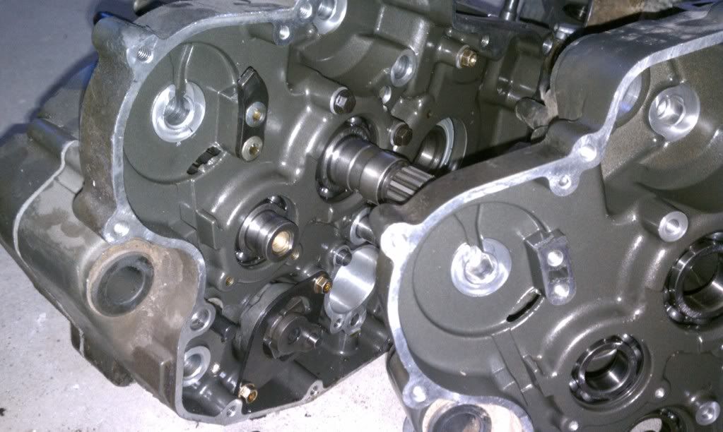

I was starting my TC 510 2006 model and managed to broke kick start shaft. I would blame my starting technique for this as I'm being used to my old CRF with auto decompressor.
Anyway I took the engine case cover off yesterday and so the shaft split in two where the shaft gets narrower.
The thing I'm a bit puzzled is a hole behind gear which goes onto the shaft. It looks like it's there for the oil flow but I'm not certain as the manual I have doesn't have a picture of this. Now I wonder if the broken shaft could have caused this?

Yes, it happened to me last year, right before the start of a moto. Anyway, easy fix. I can't remember how much it cost, but it wasn't to expensive. MotoXotica did the work and have had no problems since. The case was fine. I just broke the start shaft. I've posted this picture I few times on here. My '09 TC510:
I have some cases tonight from a 2006 250, Ill take a look when I get home to see if they have that lower hole in the casting like yours
Great, thanks guys. I've ordered the part from Husqvarna UK for about £60 plus delivery. They didn't have it stocked so I must wait couple days.
When I asked them if they have some upgraded reinforced shafts he said that they supply the 07 model ones which should be stronger. I'll compare it and take some pictures when it arrives.
One thing I just thought about.. By buying a stronger shaft, you just made the case the weak point in the assembly.. I havent seen as many '06-newer broken cases, as I have seen of the older ones, but I have still seen it. Just something to think about, it got me wondering..
Thanks! One less thing to worry about. Good point about making the case weak point. I'll call Husqvarna UK and see what they say.

Hello everybody. Doing some research I found you, and I saw that also broke the shaft of departure, I have a TE 510 / 2008 and broke my bike, like the photo below. Pesso kind enough to let me know the email address of someone who has the shaft to sell new or used, but unfortunately at present we have representatives of the brand in Brazil. I am very grateful if you can count on friends and fans of the brand. Hugs.
