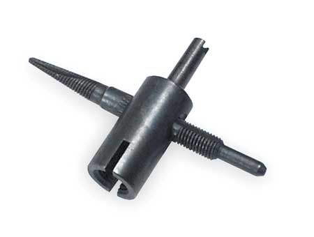

You just need a valve stem tool... I see you tried one, but the one you tried must of been to short... Mine fits in there just fine... look for a style like this at the autoparts store.
The valve stem is recessed a long ways down in the cap, since there has to be room for the rubber caps to fit in place... This is the reason it's not a plug-n-play install.
