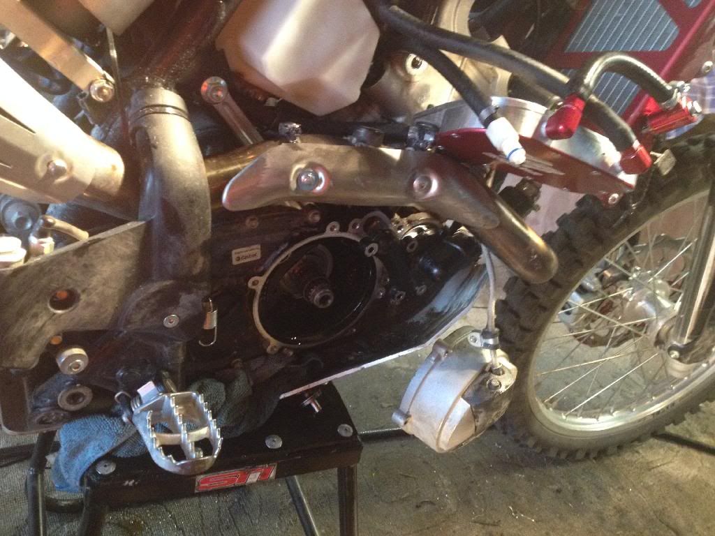

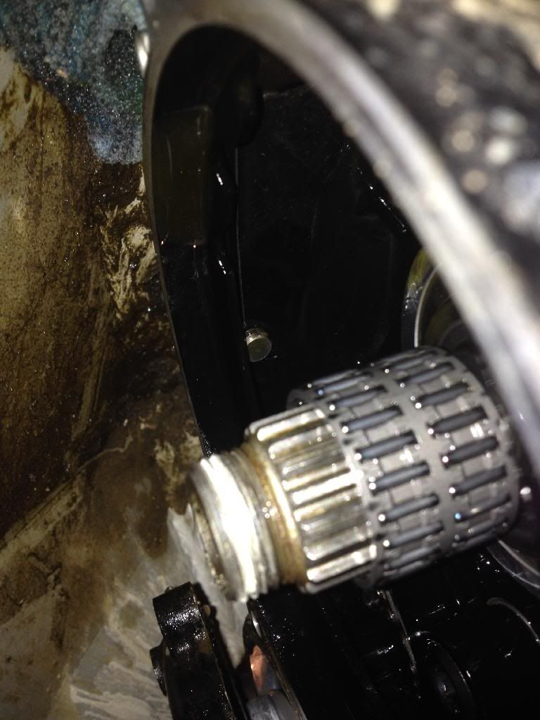

Got home from work and decided to try to get the shim from the side. Drained the coolant and oil took off the water pump cover, removed the clutch cover and basket. Lo and behold I found the little sucker!
You can run but you cant hide.
What I tore down to get to it.
About an hour and a half to tear down.
