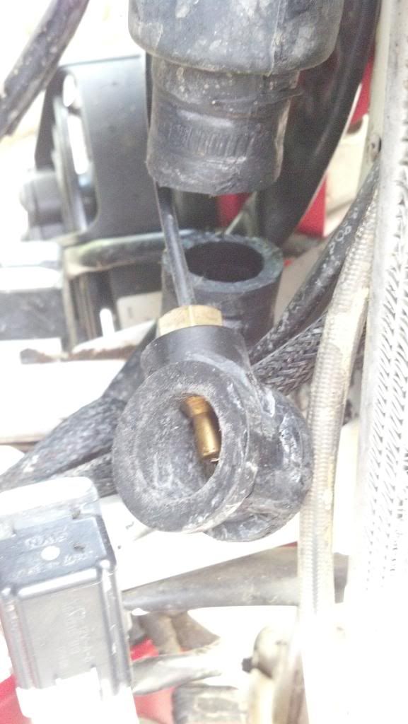

I developed a later leak at the top T where the sensor is. Can you run the bike without that sensor , I noticed a larger sensor at the bottom of the rt rad. Her the pix of the problem. The sensor housing part melted from the T.
