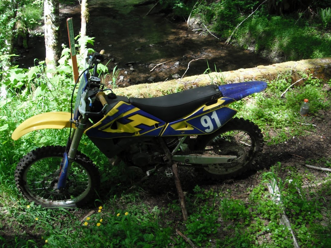

So the latest version IMS tank is much better than the previous one I tried to fit. The shrouds now fit and I don’t see any issue with the fuel pump mounting surface as it is perfectly flat. The seat will attach….but a bit tight on the rear fender.
The Seat:
Excellent. Dropped it off at FedEx 1300 Monday, and back on the bike at 1000 Thursday! Very good quality, super fast service and soooo much better on the trail.
I decided to grind off some of the plastic base for a perfect fit with the aftermarket gas tank. Just a few millimeters was all it took.
The Tank:
The bike looks great, hope it gives you alot of good service.
The issue with the fuel pump assembly bolting surface is that over time it starts getting wavy, with heat and cool down cycles, that's when the plastic in between the bolt holes starts warping, then developing leaks. Just be aware of a gas smell in your garage that you never previously had.
I have one on my TE511, one on my GG250 (taller) and just put one on my 04 CR125 i am building (taller and slightly wider). All are amazing seats. I was never real into changing seats out until I got one for my TE511 not Seat Concepts gets all my seats, I love them that much...
