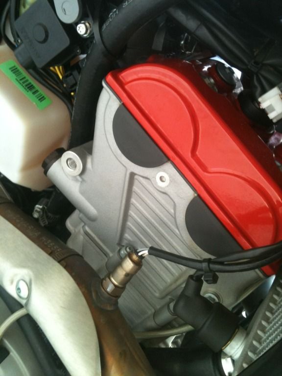

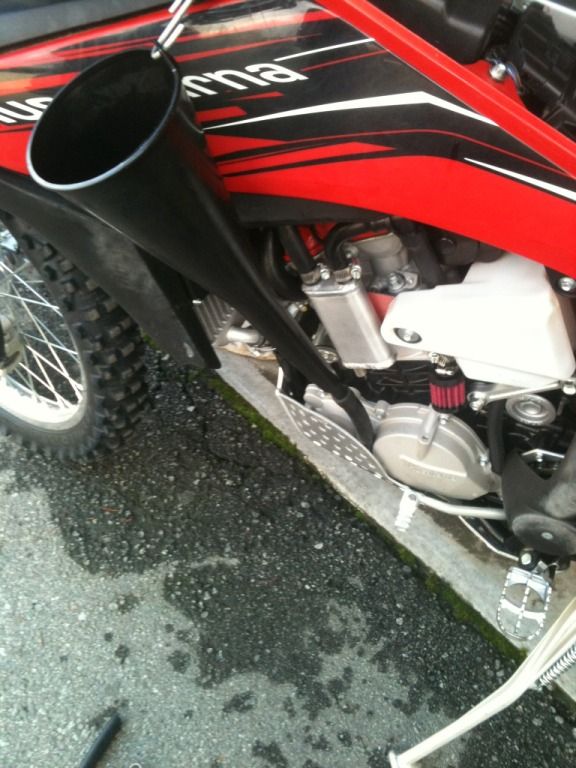

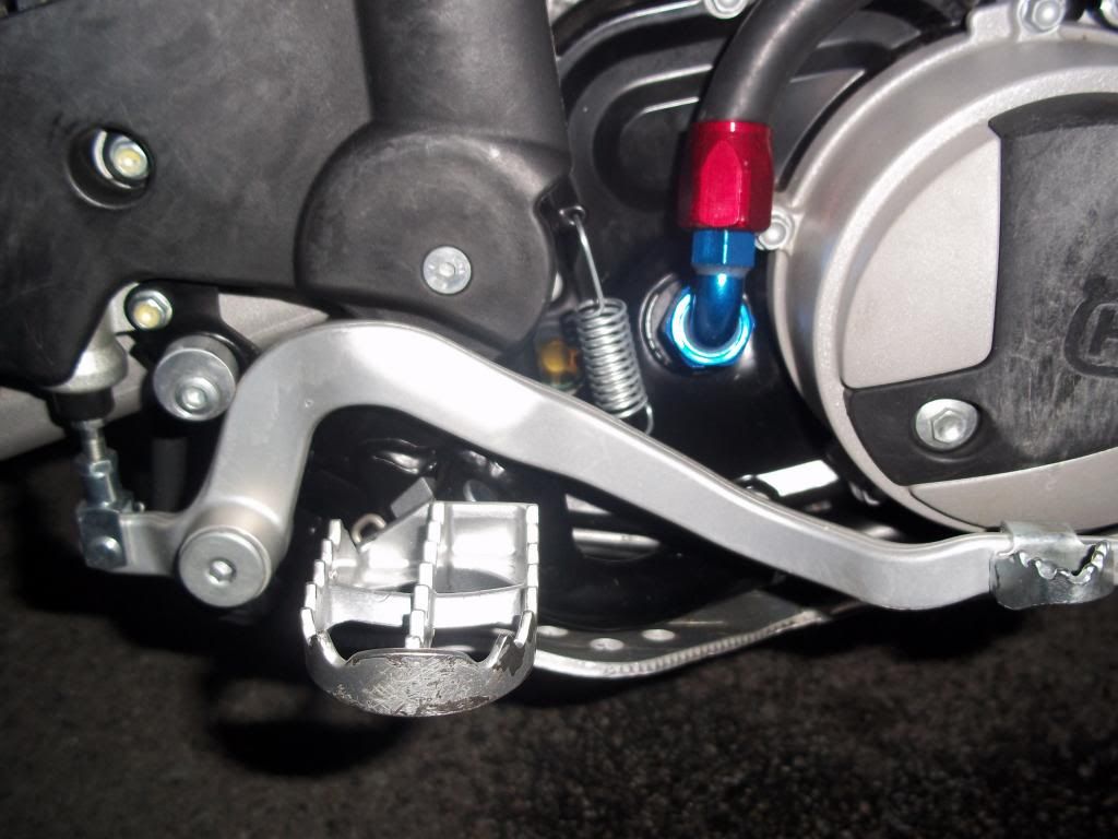

Going testing this Sunday and couldn't stop myself from sharing . Hope its "Bling Bling" enough and works great ! I will run 1350 cc oil . Any thing I should do while out there on the trail to make it cough up oil ? Like maybe ride a wheelie for a mile , lug it a-lot, rev it up going down steep hills , go up steep hills, desert whoops ...... I will try to do it all :D
I have observed that my TE449 pumps oil out of the breather at idle when the front of the bike is about 6 inches lower than the back. Also in this condition when starting the starter will sometimes stall like maybe there is too much oil in the crankcase.
tipping over always helps. I do that and my poor bike is pissing oil through the air filter and then out onto the swingarm!
Looks good. What happens when you lay the bike down on the left side, will oil puke out the filter? You still fill it at the regular filler hole? If so how hard is that to do? Does the pour out all over when disconnecting that hose at the filler plug? Isn't there a bunch of oil trapped where the oil runs under the engine?

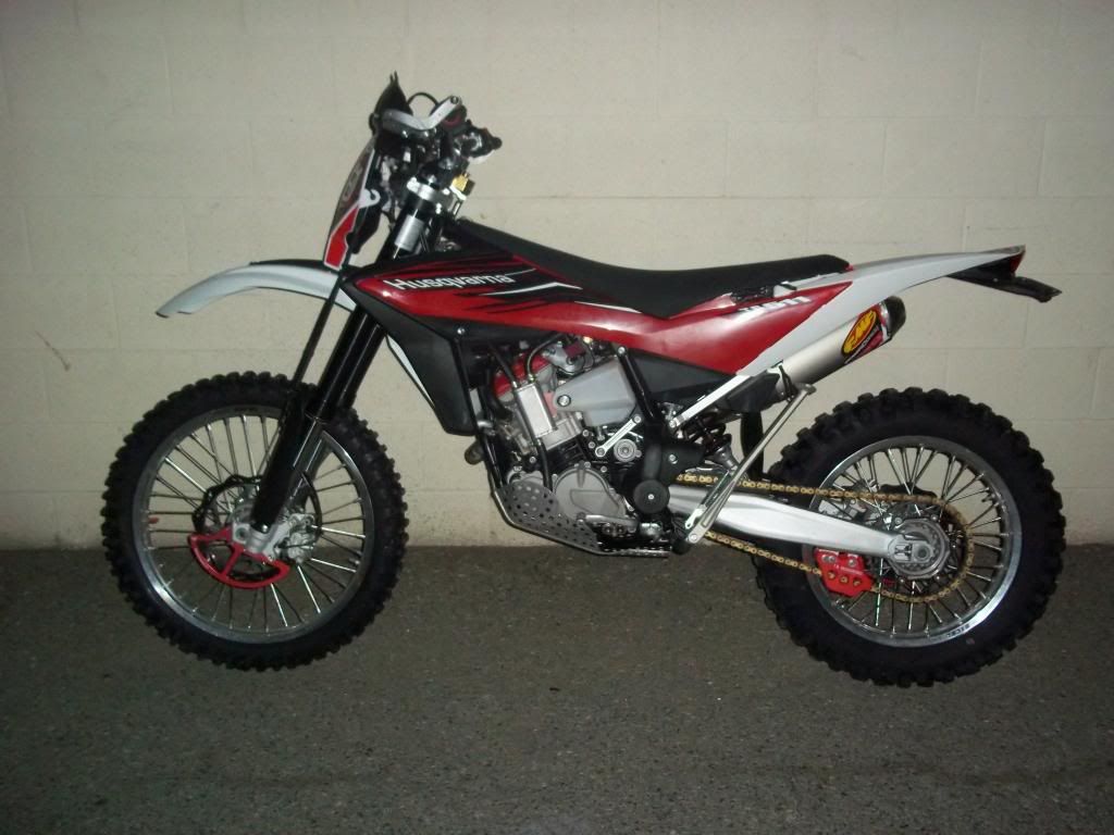

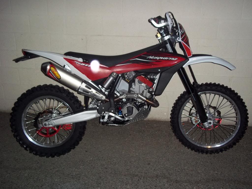

Man that muffler looks short on there. Nice.

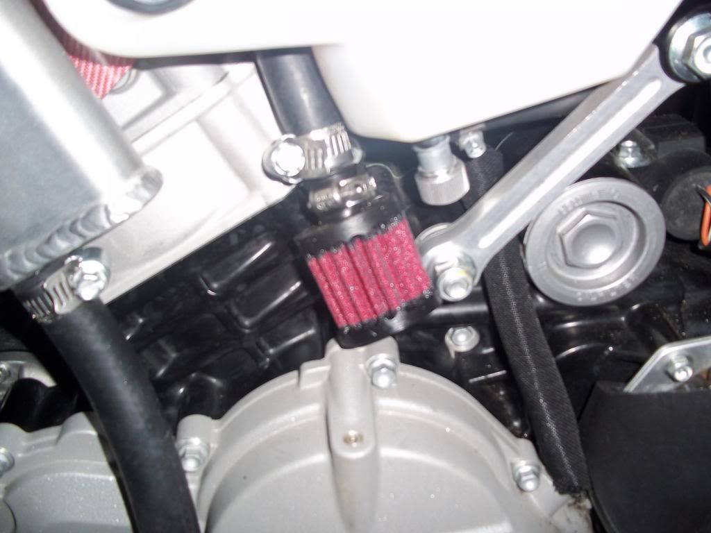

Thank you very much ! I will lay the bike over on the left and right side when I test and find out. I have the breather filter pointing down to reduce water entry into the oil system when washing, or just cover the breather.
Sustained high rpm run for a couple miles or more.....
I'm going to dump the 1100cc that's in it and plan on filling it threw the return line by loosening the hose clamp on the bottom of the box and fill it threw the hose using a funnel and checking the rate of oil return in the meantime . When I start the oil changing process the first thing I will do is use compressed air to blow threw the return line and clear oil, then pull drain plug... Just a visual inspection of the filler cap from time to time is all that's needed..... The muffler is noisey .

Even with my breather, I ran a 3 hour endurance race and the high revs made it puke out a little bit I had about 1300cc or so in mine. With a little less oil it is great now. So I would say higher revs for an extended period. But up to you if you want to do that to your bike or not..

Did some testing around town today with 1375cc.
First on the list was the return line. Transferred over well !
Road about 15 miles threw the city today, this is the freeway vid...
View: http://youtu.be/yV5CbokYbFs
This is the oil leval with the bike on its kick stand.
Not a hint of breather mist so far :banana:
I dont care for the breather filter and will leave the line open ended pointing at the chain after testing. I just want the filter on now so I can detect oil blow-by :cheers:
