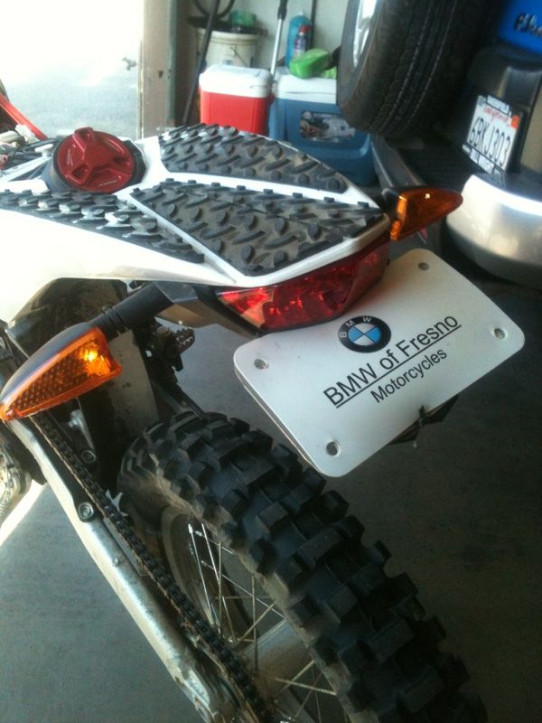

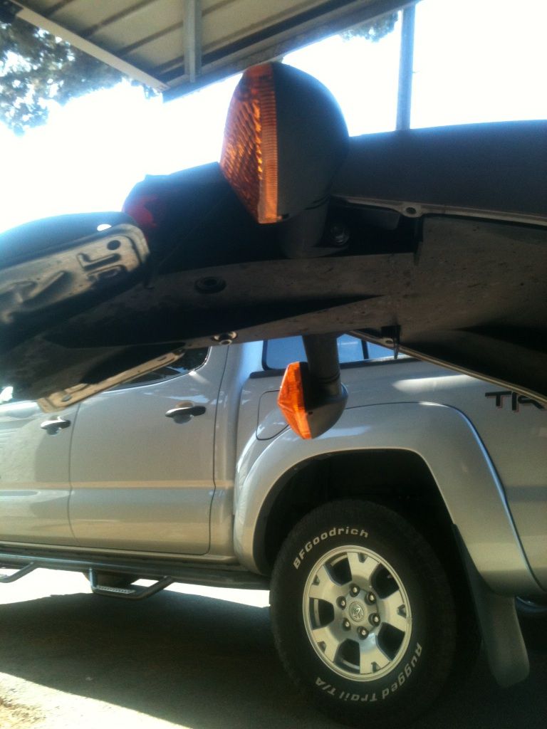

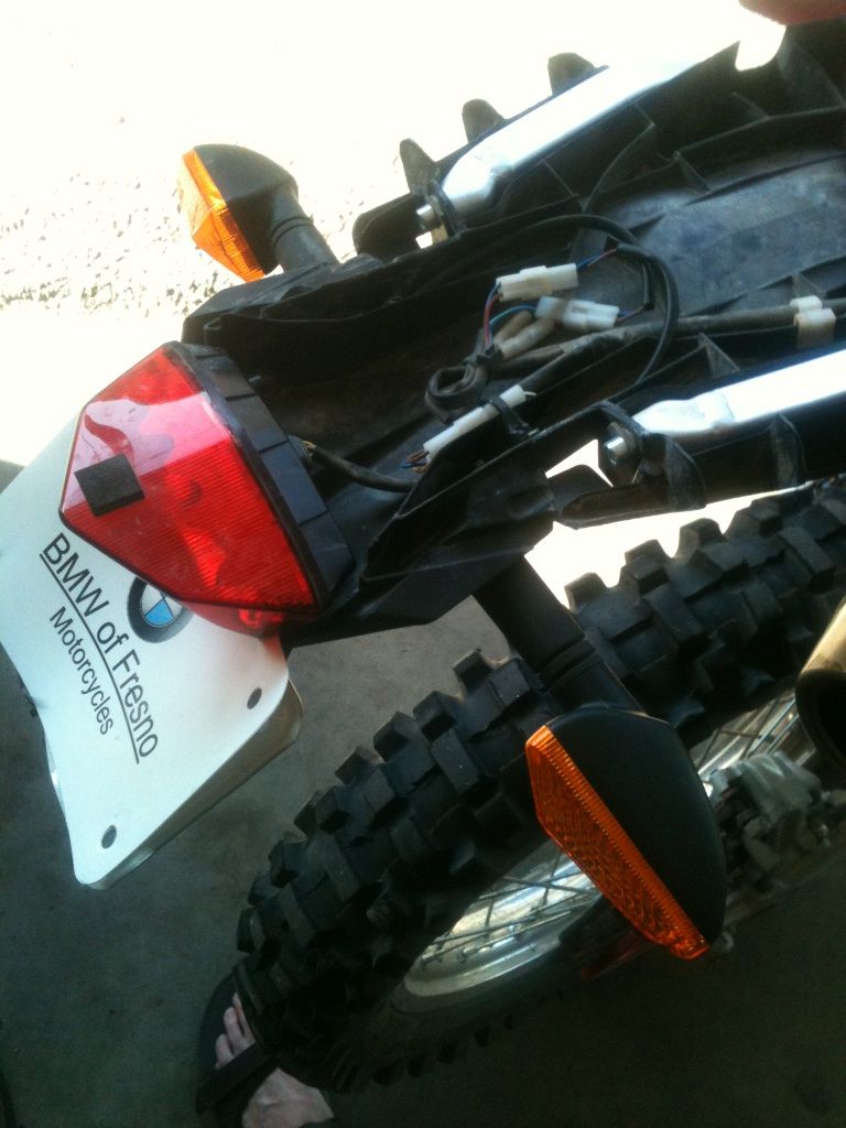

Removed sub-fender...
Drilled new holes for new turn signal location...
Zip tied licence plate to under fender .....
Caution: right signal is in-line with exhaust and might melt, a shorter signal may be best, will see . :D
If it's in the exhaust stream, it's toast....

I am going round two with this and building some lexan signals that bolt to the subframe ends and they will have a 1" LED strip . They will be unbreakable and out of the way of exhaust flow, close to the tail section. :)
I'm not sure if you can modify the existing one. I'm sure you could but its be beyond me. The brake light is still useable while the turn signal is on so you would need to find a way to seperate the lights. I know there were even kits for a WR250X so I'd imagine the kits are pretty generic.
Same place I've had mine for quite a while. Used oem indicator and it has been fine.

No problem! It was! it hung directly in the path of the stock can and had been 'worn' that way for around 6 months before I fitted the Akra. :) I'm loving the grip pads on your TE!
edit: Found more pics. I say 'directly', there is some clearance.

The last pic I can see you shortened the signals in some. Mine are still full length or they are just longer to meet our DOT requirements . Mine are defiantly going to feel the force of the exhaust . I think I might cut them down a little . I like the location because it makes removing the fender easier not having to unplug the signals.
They were the stock issue indys :) Didn't realise DOT required longer stalks? Seems strange considering you guys can get away with smaller plates, while we're meant to run 11x9 inchers. Agreed about their location :)
