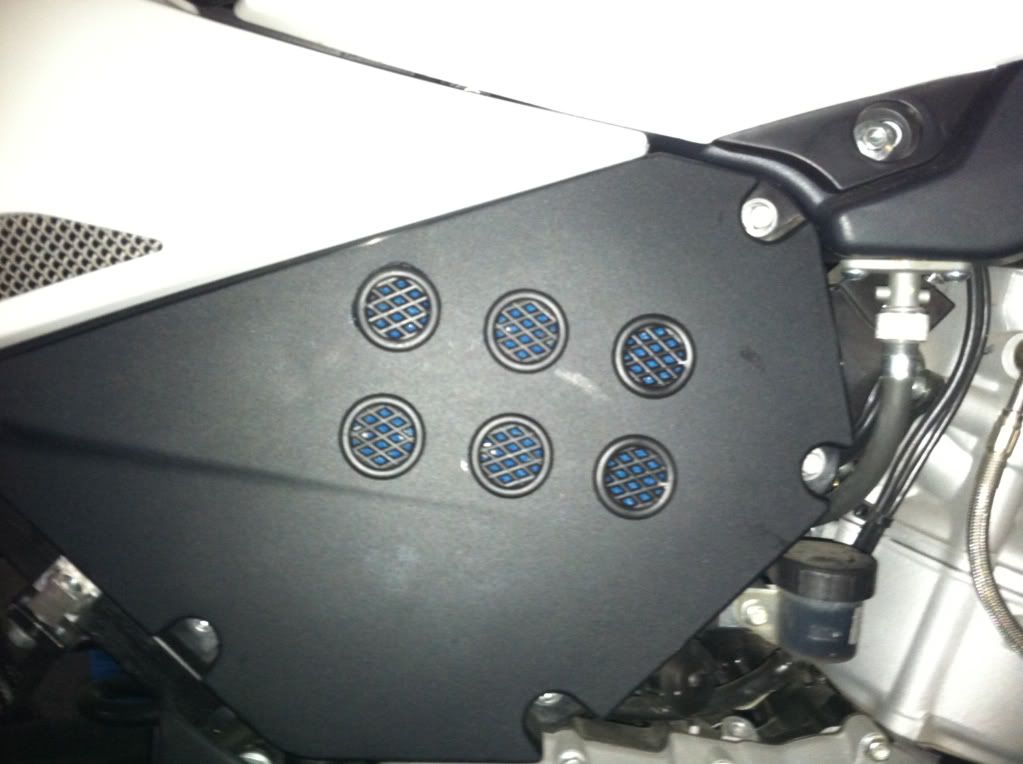

Got the AirBox Screens in today and pulled the Spark Arrestors - Def has a lot more umph down low and just pulls all the way through now - Was not lacking before but the motor is fully alive and breathing well now
God bless this damn Auto Tune - I'll get the AirBox Pic up later
***Edit***
These are the screens I bought for the Air Box Cover - 1 Inch Drill on the back side of the cover tween the old snorkel guides, pop in from front with a little Pro-Taper Grip Glue and PRESTO

Dig it for sure
Here is my finished Product - Never mind the smudges on the cover - Got rained on a bit as I was rolling home yesterday and Yes, I know, I need to swap my rear fluid......

Please explain you method! I was thinking the same thing for the 610, but couldn't find the rubber grommets.
Listed in this thread amigo - 1 Inch drill bit - Drill from the backside of the cover inbetween the snorkel (which was removed upon power up) guides - Once the holes are drilled, line the little ring around the top of each of the (6) filters that come with the kit with Pro Taper Grip Glue (what I used, any super glue would work) and then pop these in - They are a tad larger than the 1 inch hole but fit in perfectly - The glue around the top ring of the filter insures they stay in place - Enlarge the pic of the filters in the provided link and you will see the "rim" that with the glue holds them in place
Let them dry for (15) mins (or whatever the glue stipulates) and rip on said bike
