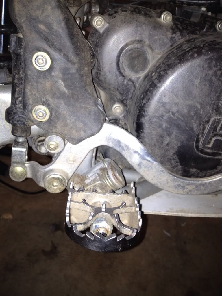

I bought a set of fastway pegs (think they were evolution 3) and they fit on the spindle but will not fold back at all in the lowboy position. I really need wider pegs than stock and preferably ones which will take them a little lower and a little back. I haven't posted enough to be able to PM Husky666 to get his plates, but I could really do know from someone who knows more than me exactly what pegs would do the job. I don't want pivot pegz though, just something wider and hopefully a little lower. Any suggestions which will definitely fit and fold back in the normal way?

I am using the Fastway pegs in the low position. I did have to do a little grinding (left side on the frame I think) to allow them to fold back. It wasn't a big deal.
When i worked at Fastway 10 years ago I said we needed to change the rear part to the 45 degree angle to facilitate them folding back. You would loose no functionality. Investment cash molds are expensive to modify.
- they are (or at least were) 17-4 investment cash stainless steel if you wanted to have a welder modify them, would not be a huge deal. Knock the corner off and weld an angled part in.
Cheers guys. Seems like it's taking a long time for a moderator to approve my replies. Not even sure why there has to be moderator approval really, it's frustrating. Might try the modification as you both suggested.
Actually I think the peg bracket itself needs modding more than the peg (right side of bike anyway)
I put Fastway's (Evo 3) on my '09 610 yesterday... weird, the right one in the Lo-boy position won't fold, but the left one does. I haven't ridden them yet, but I like the size. Looks like the right footpeg bracket is just shaped different than the left one; I guess it could be cut/ground down, but I don't want to weaken it.
Grind away. You'll be fine.

i put fastway peg on mine. i had to round off the square corner on the right side mount with a grinder but otherwise a very easy fit.

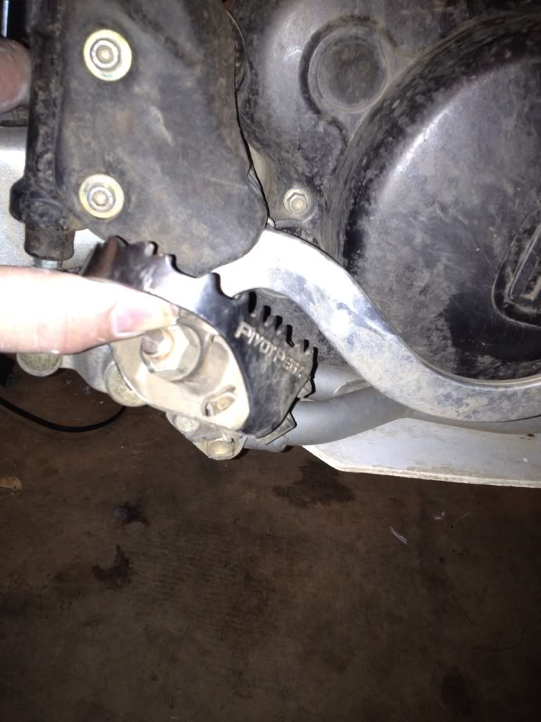

Pivot pegz. They fold up in low position. It takes a bit to get them up when new, but once the go up a few times and make a groove for the spring it's no problem
Yes, stainless, 60mm or whatever the biggest ones are and most but not least, they pivot. It feels funny to ride a bike with standard pegs now. I love them!
