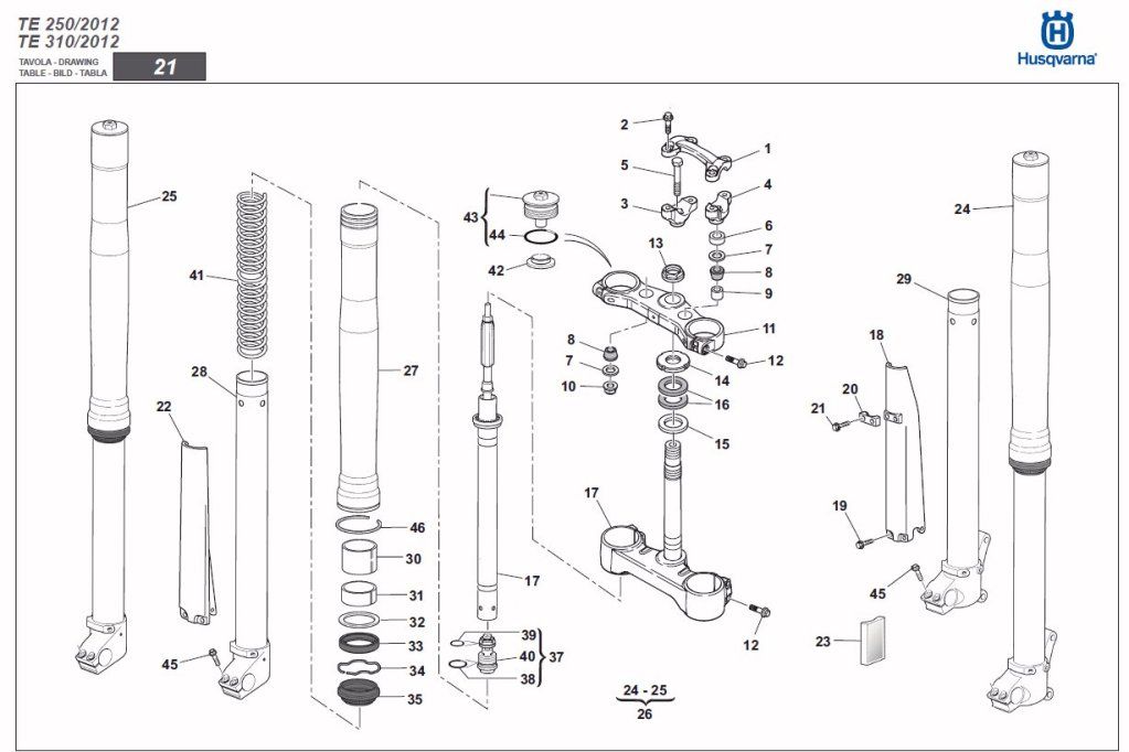

Maybe the schematic will help....
Mike AK, do me a favor.
I believe part #42 in the schematic above is shown upside down. When you pop your cap off (which I assume has not been off since leaving the factory), tell me if I'm wrong or not?
Thanks!
Thanks OHR. As far as I can tell from the service manual, bolt #12 is an M8 and should be torqued to 25Nm, correct?
Aaron8, I will check and let you know. I plan to do the work on the 2nd so I should have you an answer then.
