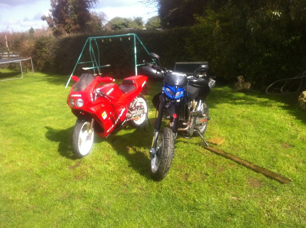

I've just come from a cagiva mito to my husky 610
Everyone loves pictures!
