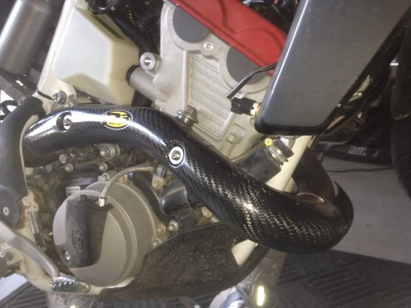

Is anyone using a carbon fiber pipe guard? The header looks like it wants to burn me, and then get dented.

P2 (Pirie) makes a nice header pipe guard but they tend to be slow on delivery. http://billshusky.com is Salem Oregon has a couple in stock and no doubt would be happy to mail ship you one. Give em a call and ask for Bryon or Don. But buy one before you become the next victim of the 'pants on fire' crew... :)

The Race Map II jumper should come with the bike free of charge. The O2 sensor plug cost me. Many have told you really don't need to remove the sensor, though. I did. Get the header pipe covered with something, or you'll burn the heck out of whatever contacts it. I wrapped mine, which was cheap and effective, but expect to get the P3 eventually.

I need to cover the front pipe as I 've already burnt 3 holes in my brand new lindstand GI pants, is there a cover that can be fitted as I can't find any here in the UK.

Yes, from these guys: https://pirieperfprod.com/
Touratech also makes one here: http://www.touratech-usa.com/Store/951/PN-410-5070/Exhaust-Manifold-Guard-Husqvarna-TE-449
And welcome to the burned pants club! It's a right of passage.
Hello Tuddy121, i'm also from the UK. The exhaust guard i purchased was for a Beta trials bike clicky: http://www.trialsuk.co.uk/products/exhaust-shield-to-suit-beta-or-sherco

Received mine and installed it today, here it is:
