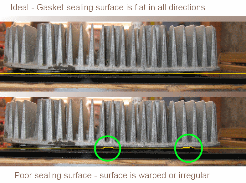

I would pull the head and cylinder, and check both on a piece of glass, I wouldn't trash the motor until a few more inspections were done. There is only 1 place where coolant can get into the combustion chamber and that's where the head and cylinder come together.
There could be a crack in the head that's allowing coolant in when the motor is warmed up, or as olderhuskyrider says something isn't flat. Probably the barrel as you already had the head skimmed.

Check both head and barrel to make sure they are flat first, this is the more likely culprit.
