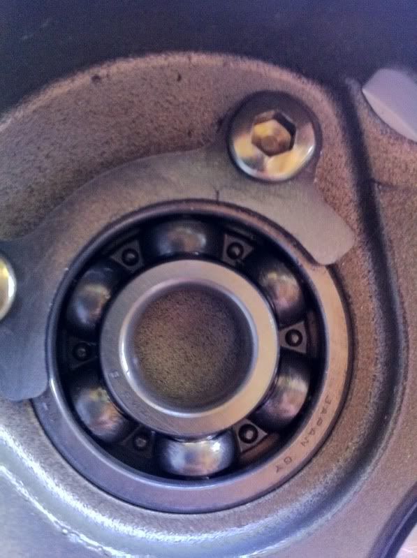

Hey guys, while I dig through parts diagrams I'm wondering if anyone recognizes what this little piece of metal is (?) Just found it stuck to my drain plug (magnetic) and hope it's not serious. I've got a race this weekend.
It looks like a gold colored bolt head of some sort yet it's smooth on both sides with an inset allen pattern. 4 or 5mm maybe, I will confirm. the head is ~11mm across.
The bike has always ran great, very little shavings on the screens, like specs only, and these two chunks were the only things I found. Thankfully it looks like they stuck directly to the drain plug and stayed there. Rode the bike two days in a row last weekend or so. No issues.
Anyone recognize this part?

the odd thing is it's smooth on both sides, with a curve to the surface. one side is more angled. doesn't appear to be a bolt head (but i'm not positive).

are the backsides of those retainer bolts recessed? maybe what i labeled 'front' above is a recessed back?

ah, hah! nice work, Pinit :thumbsup: now the question is... which bearing. so it seems this little bolt worked it's way loose then got sheared by some gear teeth.
do you think it's safe to run it? i'm trolling through the shop manual now to see where these are used.
They are used in all the bearings. Prolly a dozen in there. Its your call to run it. Some retainers only have one screw some have two like the one I posted. If that plate starts bouncing around your gonna have real issues. But tough not to race on a big weekend either.

Here are some pics from my 08 TXC250 ... There are a few gold looking items in my machine ... Along with the mains retainers, there are 2 other retainers where that gold looking, hex head both is used is this pic .. Not sure what what the other two places shown here on the upper left side of the cases are holding ...100_6014.JPG
This shows what shafts are running off those 2 bearings on the upper left..

it looks like quite a few of these gold hex heads hold a single plate, that bums me out. so curious why i didnt see any other shavings though. it was literally like the head sheared and got shot right to the base of the motor.
